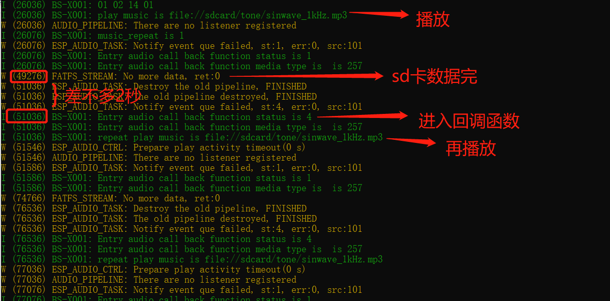

使用esp_audio_pay 播放SD卡音乐发现播放完成后要2秒才能进入回调函数
luxianquan
Posts: 21
Joined: Tue Jul 13, 2021 12:23 pm
Postby luxianquan » Wed Jan 19, 2022 8:10 am
我想使用esp_audio_play 来播放SD卡音乐,用回调函数判断播放完成后重新播放,进而实现循环播放功能。
现在的问题是:每次播放完成后都要差不多2秒才能进回调函数。
我的程序初始化是:

回调函数是:
void audio_service_cb(esp_audio_state_t *audio, void *ctx)
ESP_LOGI(TAG, "Entry audio call back function status is %d",audio->status);
ESP_LOGI(TAG, "Entry audio call back function media type is is %d",audio->media_src);
esp_audio_state_t state = {0};
esp_audio_state_get(test_handle->player, &state);
if(test_handle->work_mode != SD_MODE)
return;
if(music_repeat == 1){
if((audio->status == AUDIO_STATUS_FINISHED)&&(state.media_src == MEDIA_SRC_TYPE_MUSIC_SD))
ESP_LOGI(TAG, "repeat play music is %s",music_name);
esp_audio_media_type_set(test_handle->player, MEDIA_SRC_TYPE_MUSIC_SD);
esp_audio_play(test_handle->player, AUDIO_CODEC_TYPE_DECODER, music_name, 0);
test_handle->work_mode = SD_MODE;
播放功能就是正常的函数使用:
memcpy(music_name,url,strlen(url));
ESP_LOGI("BS-X001", "play music is %s",url);
esp_audio_vol_set(test_handle->player, music_volume);
int duration = 0;
esp_audio_duration_get(test_handle->player, &duration);
ESP_LOGI("BS-X001", " music duration time %d ms",duration);
music_repeat = raw_datas[3];
附件是日志内容
