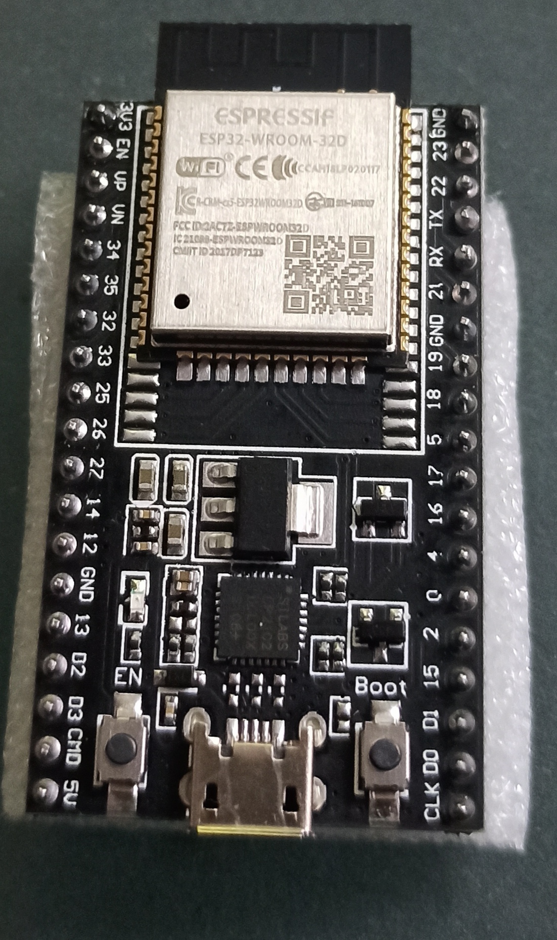

That doesn't look like a code of any module I know of (but then again, I don't generally make it my business to know of every single module, so who knows.) Can you post a picture of the module?

This is the module
How do your normally register a device onto a DB prior to a device joining your network or being give to a customer.

The Wrover-D is an older module... might be that it's made before they added the MAC to the qr-code.
I would imagine most manufacturers would register the MAC either during the stage where their product is factory-tested and flashed with the actual program, or they don't bother and let the device send the MAC when it's deployed at the customer site and contacts the manufacturers servers.
