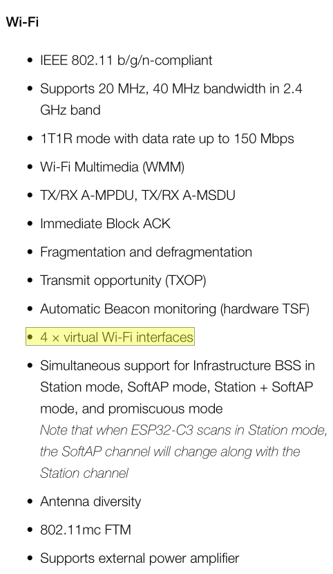

from the ESP32-C3's datasheet I saw the following feature (I underlined it):
WiFi
I searched for it to understand the meaning/how to use it, however I'm not able to find an official explanation about it (and how to use it using ESP-IDF).
Maybe I can handle more devices simultaneously when using ESP32 as a AP?
Thanks in advance

The idea is that you can handle 4 different 'modes' at the same time, for example STA + AP + ESPNow + monitor mode. ESP-IDF handles this 'under the hood', you can simply e.g. set WiFi to sta+ap mode and start up esp-now.

Thank you, now it's clearer the meaning of virtual
