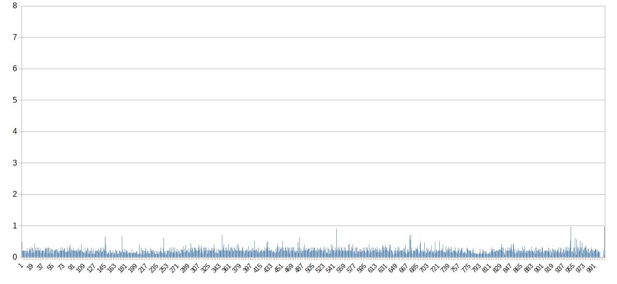

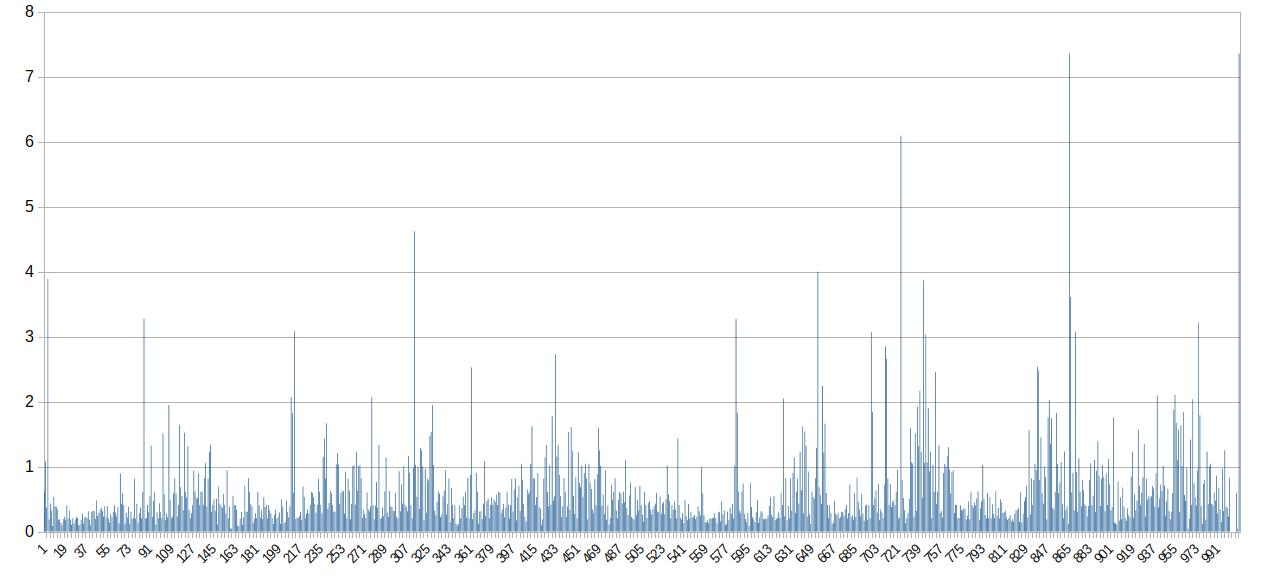

I am testing capture frames with ESP-CAM device and transfer data using WIFI to a Rasp4.
The results shown below are from 2 instances of 1000 frames in total.
2 first graphs below represent measurement taken in different hours of the day.
There are a big difference, as the graph shows...
fast
slow
Vertical is time, measured in seconds (8secs max scale).
Horizontal is 1000 pictures transferred by wifi, from ESP to Pi 4.
Table below show the actual numbers from eash measurement.
fast-GRAPH
Start  :2022-02-17 20:23:12.201321
Finish :2022-02-17 20:26:57.507617
Total seconds: 0:03:45.306296
0.225187827348709	  AVERAGE
0.054800987243652	  MINIMUM
0.956576824188232	  MAXIMUM
slow-GRAPH
Start  :2022-02-18 15:20:17.437005
Finish :2022-02-18 15:30:14.457416
Total seconds: 0:09:57.020411
0.59687663269043	  AVERAGE
0.04627799987793	  MINIMUM
7.35434556007385	  MAXIMUM
Hardware setup:
ESP32-WROOM-32E (M5Stack UnitCam) to RaspberryPI 4 RaspOS 32Bit
Antenna to Antenna = 7cm apart
Software setup:
ESP32 { sketch to capture CIF (400x296) JPEG, send by WIFI (ESPAsyncWebServer) }
P4 { python3 script to get jpeg img from ESP32, save to ramdisk directory }
Eash JPEG image size is approx. 5.5 Kilo Bytes
At this point, it does NOT seems to me that the issue is related to software, since the soft setup is exactly the same, and simple...

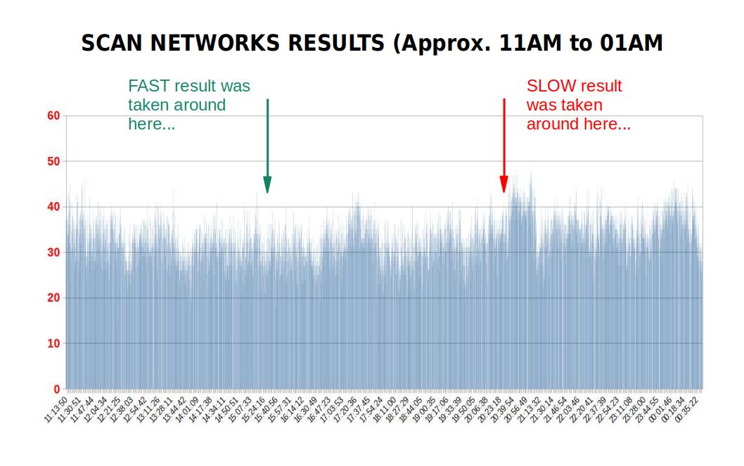

Around the time for the SLOW graph, there was more or less 30 SSID detected in the area (Arduino IDE "scan wifi" sketch example)...
Scanning for about 4 hours continuosly, around the same time of this measument, shows a total of about 160 different SSIDs, with the maximum simultaneos number of 46 SSID at a given time...
The third graphic is the numbers of networks as detected by Arduino IDE "scan networks" sketch.
Vertical (RED) is the number of SSIDs detected.
Horizontal are the hours: start around 11AM to little past midnight.
scan ssid
Unfortunatelly, I don't have yet these 2 sets of measurements in 24 hours period to place side-by-side and look for possible correlations... and see if the number of WIFI networks can show effects in the average time for frames (JPEG) transmission... looks like these measurements will be a MUST to be taken, in the pursue of a better understanding of the issue...
[Questions]
Is the SLOW measurement result of some kind of "RF pollution" (too many WIFI/RF around the location)?
If this is some constraint of the PCB Antenna, what can be done to mitigate the issue?
Is there any recommendation to get a more uniform result in a 24hour operation scenario?
I have just started to collect data by making measurements.
At some point I will be doing measuments changing distance, size of picture, as well as protocol of communication, like TCP, UDP, WebSocket, etc...
By then, I should have a fairly good idea of the limitations of my hardware/software setup and what are the option which gives me the most uniform results.
The reason I am asking for recommendations or if there are any "secrets" to know, without even finishing a first round of tests is because, comparing the total time, in seconds, that the first instance took to transfer 1000 photos (Total seconds: 0:03:45.306296), with the second instance (Total seconds: 0:09:57.020411), I was a little bit surprised and decide to share this initial result and ask if there are any recommentation to follow in the search of a more uniform behavior...
I have already spend some time testing how much the (wired) serial interface can do to transfer images from ESP to SBC, now I will be doing some tests with WIFI...
My current goal for the ESP-CAM is simple: transfer still frames of about CIF (400x296) resolution in JPEG format to a PC/SBC, something around 2 frames/second should be fine.
So, 1 second latency is OK, but the 8 seconds is a concern...

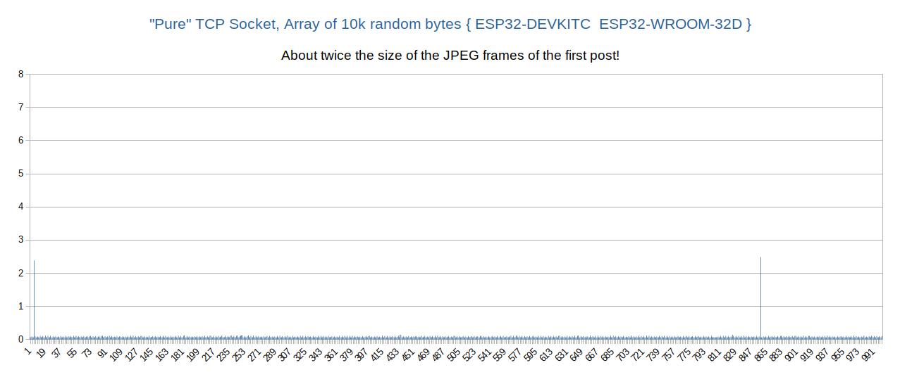

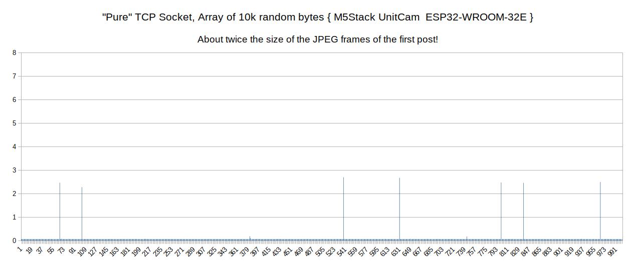

Just want to show another preliminary data.
This time, instead of HTTP, just using TCP socket.
And, instead of JPEG frame from ov2640, just random 10 kilo bytes...
First M5Stack:
Below is DevKitC:
M5Stack UnitCam - Pure TCP Socket Array Random 10 kilo bytes
ESP32-WROOM-32E
0.077702605724335	Average
0.058227062225342	Min
2.69398665428162	Max
ESP32 DevKitC - Pure TCP Socket Array Random 10 kilo bytes
ESP32-WROOM-32D
0.078360189437866	Average
0.057132959365845	Min
2.481693983078		Max
Data is about twice the size of the JPEG frames of the first post.
The large variation in time is GONE!
Result shows a very uniform envelop.
The M5Stack (WROOM-32E) and DevKitC (WROOM-32D) shows basically the same result...
Looking at these preliminary numbers, RF interference, if exists and impacting the results, is now at very low levels...
I was expecting that pure tcp and udp packets will show better results, but I am surprise to see a smooth behavior, very uniform, almost without any variation!
Well, I will continue, hoping to have also udp, websocket to compare...
