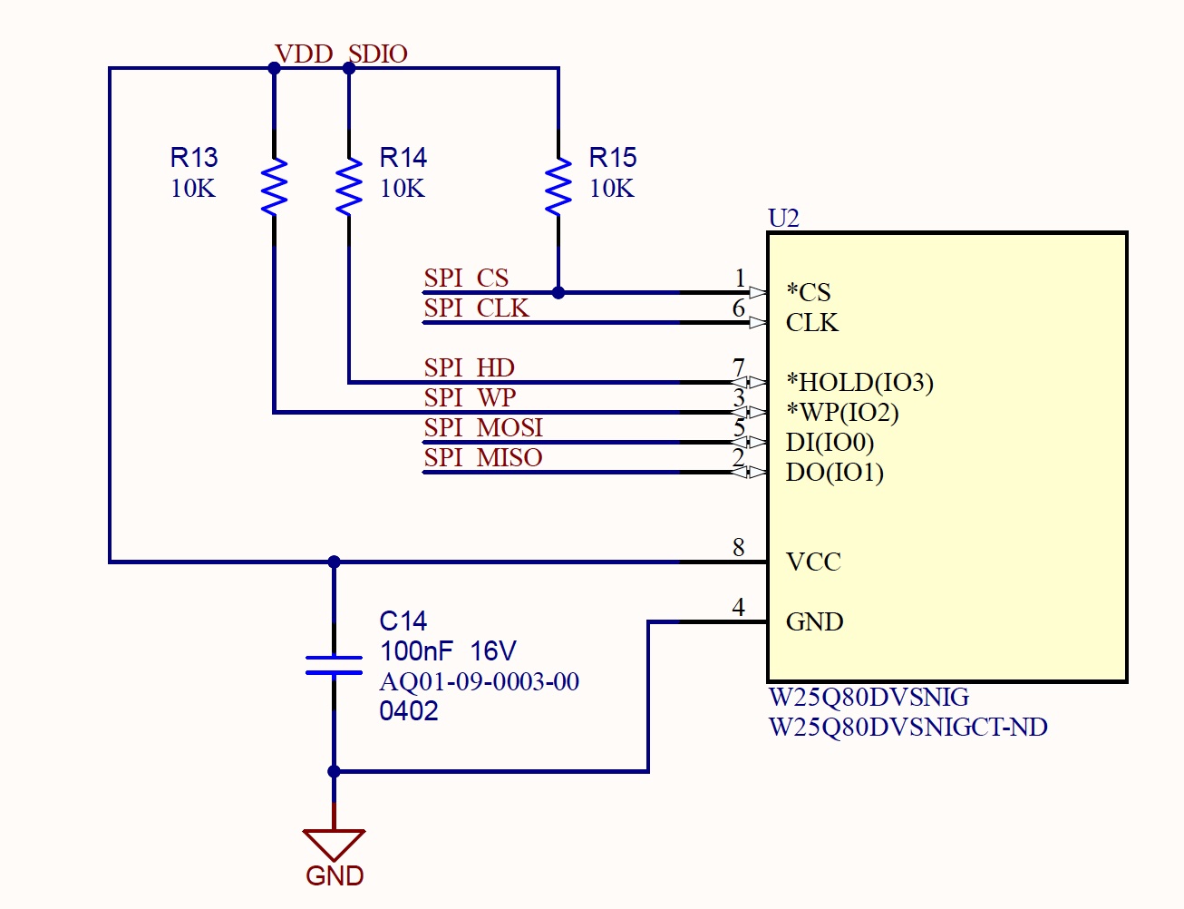

I have a custom design with an ESP32-D0WD-V3 with an external Winbond W25Q80DVSNIG flash IC. When trying to flash a program onto the device I get this error message.

I am using a Dual I/O setup and setting the VDD SDIO voltage to 3.3V.
SPI Setup.jpg (59.39 KiB) Viewed 9966 times

brent.yiu: bit late, but I think you swapped the DO/DI lines...

I have a SD Card connected to:
#define SPI_MISO 12
#define SPI_MOSI 13
#define SPI_SCK 14
#define SPI_CS 5
... and I couldn't upload if I had my SD Card Inserted and used it in my code. But if I took the SD card out or commented out the use of the SD Card, I could upload again.
I believe it is because
boot will fail if GPIO 12 is pulled high
according to https://randomnerdtutorials.com/esp32-p ... nce-gpios/
When trying to erase I get same message
WARNING: Failed to communicate with the flash chip, read/write operations will fail. Try checking the chip connections or removing any other hardware connected to IOs.
