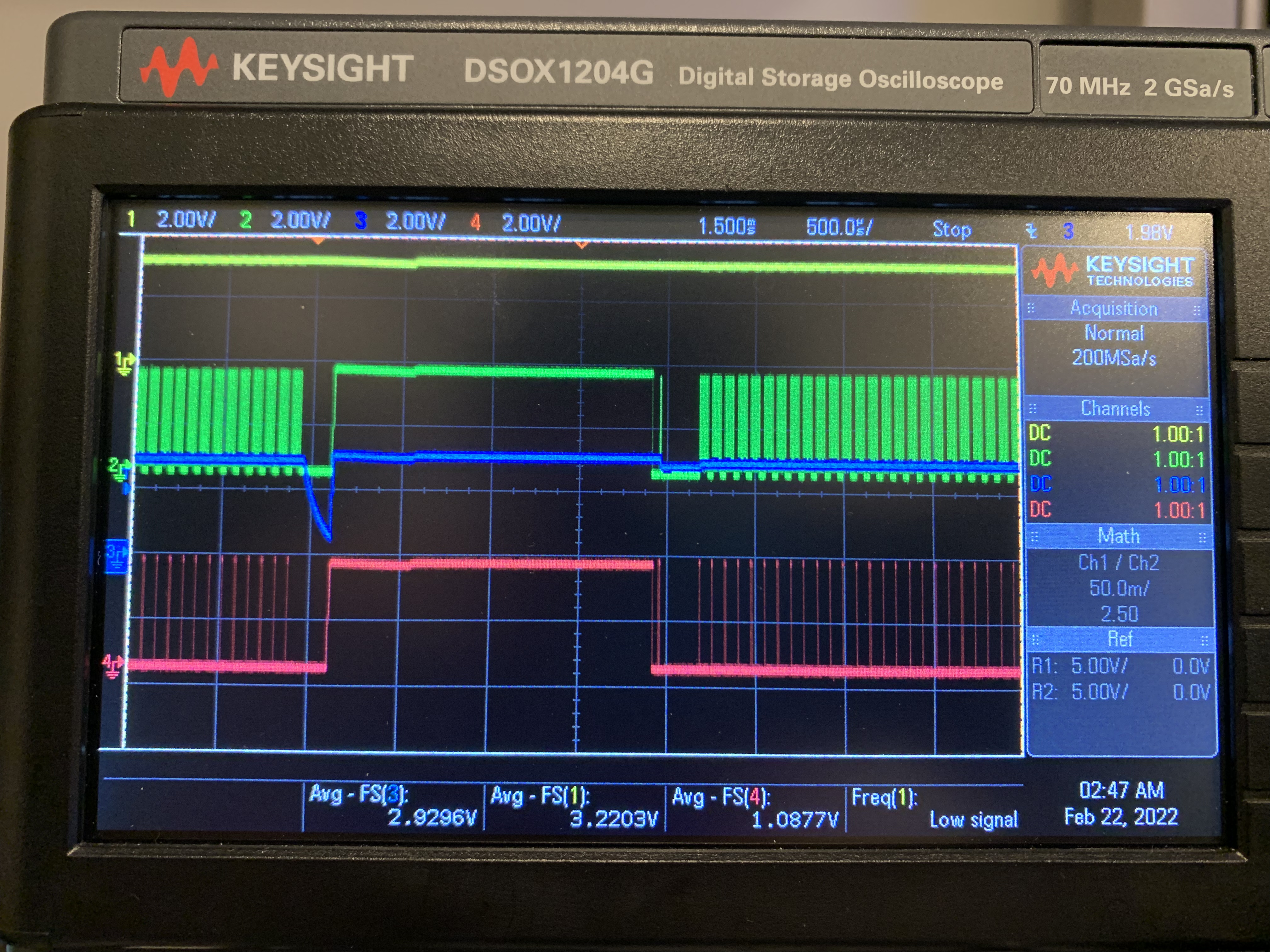

I have a custom design using the ESP32-D0WD-V3 and am seeing a weird glitch on several I/O pins. It is causing me to not be able to flash the ESP32.
Here is a picture of the glitch that I am seeing.
Yellow Trace = VDD for Flash Chip (VDD_SDIO)
Green Trace = SPI Clock
Blue Trace = SPI MOSI
Red Trace = SPI MISO
The SPI MOSI trace shows a the glitch and then you can see the CLK and MISO lines immediately go high. This causes the SPI bus to not work and I am not able to flash the ESP32.

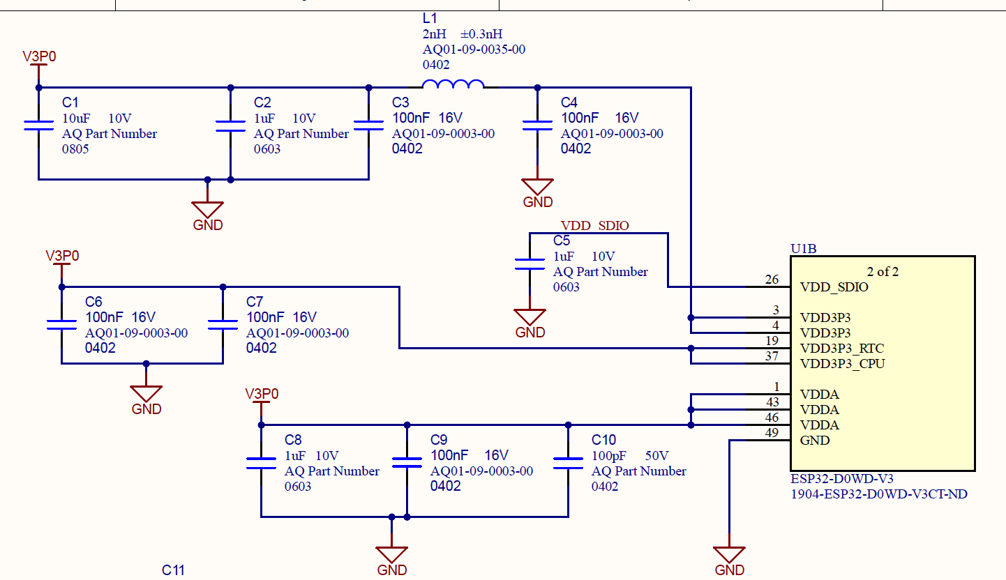

I have tried connecting the ESP32 directly to a 3.3V DC power supply with a current limit of 1A and I am still seeing this glitch so I don't think it's a problem with the power rails. I also think I have the correct decoupling capacitors for the power pins as shown in the picture below.

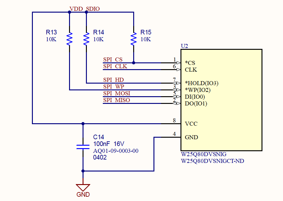

For the SPI Flash I am using a Winbond W25Q80DVSNIG and have 10K pullup resistors for the CS, HD, and WP pins of the flash as shown in the picture below.

I think I figured out that it is now due to the Watchdog reset occurring continuously. Here's a serial print of the resets happening.

It continues on like this forever. Is there any way to disable the RTCWDT_RTC_RESET?
Re: Glitch on Several Pins
Posted: Wed Feb 23, 2022 1:19 am
by Sprite
That's the ESP trying to boot from the flash and failing (presumably because it's empty?); getting rid of the WDT isn't going to help you there.
