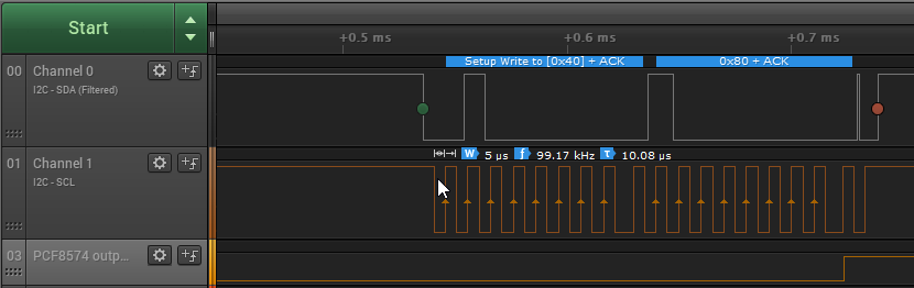

Unfortunately I am experiencing similar problems while working with the I2C peripheral.
The I2C peripheral stops working after a random amount of time.
The first I2C device I use in a lot of projects is the PCF8574 I2C IO expander. The code is supposed to toggle P7 high/low. The other tasks that are running don't use the I2C peripheral.

This code works for an x ammount of time, but always leads to an error ( esp_code 0x107). The error is caused by the following part of i2c_master_cmd_begin() located in the file i2c.c:
 res = xSemaphoreTake(p_i2c->cmd_sem, ticks_to_wait);
    if (res == pdFALSE) {
	    ESP_LOGE(I2C_TAG, "Timeout 2!");
        ret = ESP_ERR_TIMEOUT;
I dont think there is any hardware related problem in my setup. The last output generated by the esp looks good to me. After this sequence nothing happens on the lines anymore ( program is still running but outputs the 107 error):
So I think the semaphore is not released somewhere (within the specified block time). I am new to the freertos, and I can't figure out why the semaphore could be in use by anything else.
Anyone ever experienced the exact same issue and was able to solve it?
