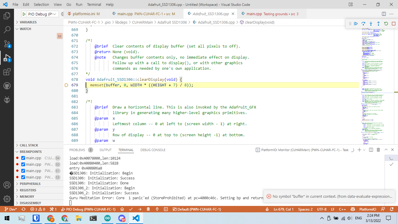

After I added another OLED display, the Initialize routine seems to cause crashes, but I don't know how to fix it.
Debugger screenshot
Screenshot (12).png (201.59 KiB) Viewed 1789 times

Postby Sprite » Mon Mar 14, 2022 1:01 am
Possibly an issue where the display library doesn't support two displays (at least in the way you use it). Can you decode that backtrace? That usually helps zoom in on the error.
