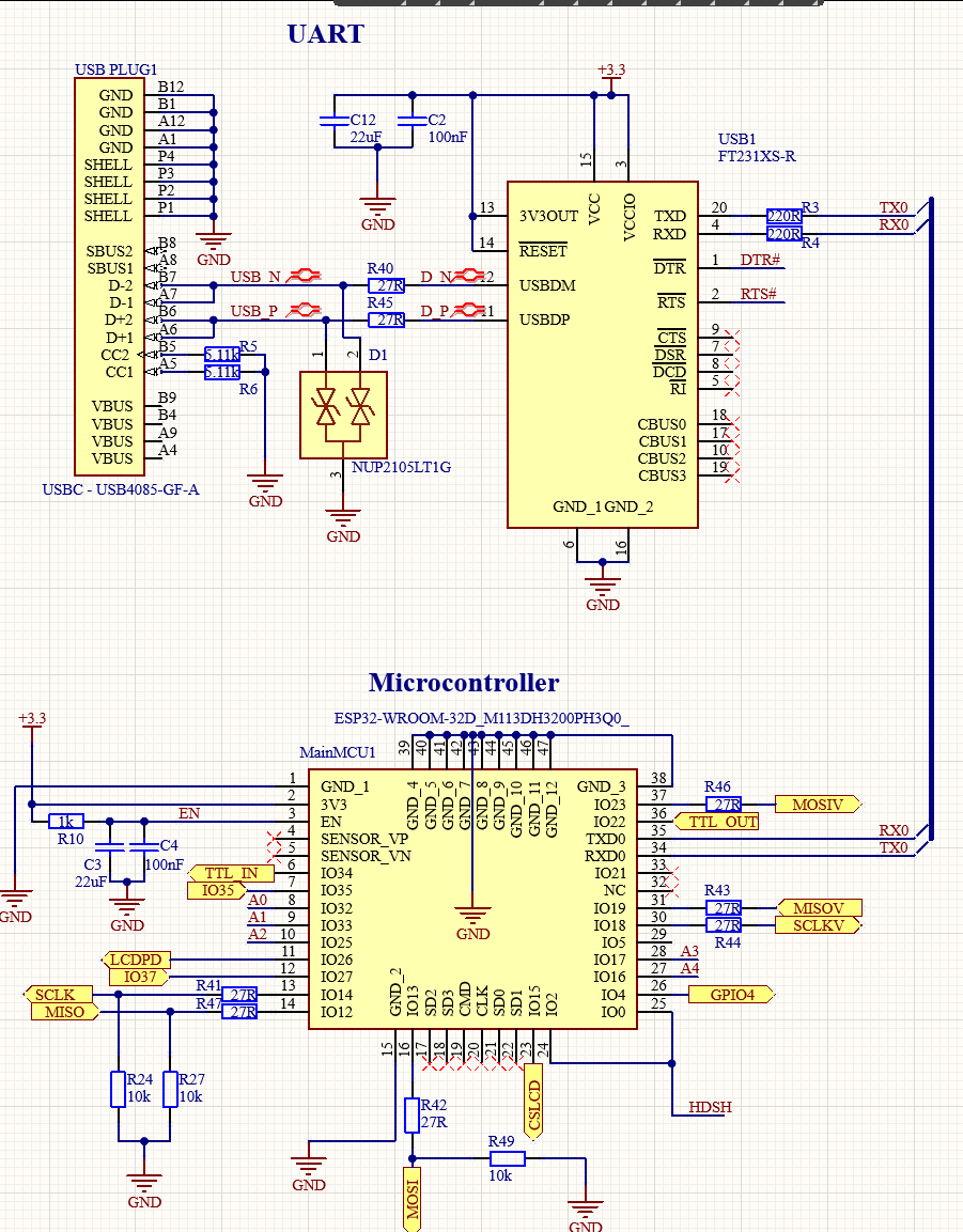

I have my custom-made ESP32 board.
After soldering, I can only talk to some of them.
To these boards, this is the uploading log:

I'm using Arduino IDE to upload the code.

Here's my schematic:
This is driving me nuts,
Thank you in advance.

Postby thaintrinh » Fri Mar 18, 2022 12:53 pm
I don't have a RESET button on the board. Should I just connect pin 9 shortly to GND?
Although, when the board is plugged in the computer, GPIO22 is floating.
However, when I remove the USB connection (power is still there), pin GPIO22 is producing 1,2V.
That's really weird.
I'm using ESP32-WROOM-32U.
Thanks again for helping me :)

Is the schematic the entire schematic? Normally, there's a little two transistor circuit that connects between DTR/RTS and IO0/EN. If you do not have that (or there's something wrong with it), you indeed need to manually mess with reset and IO0 to flash/run your program.

Postby thaintrinh » Mon Mar 21, 2022 5:51 am
That's not the entire schematic. I have 2 transistors which control the DTR and RTS pins and these two have been working fine.
I doubt that this have something to do with the flash of the ESP32U. As I don't have the hardware ready for the flash reset. I had to upload the empty code 10 times.
If you have any insights, please share with me :)
