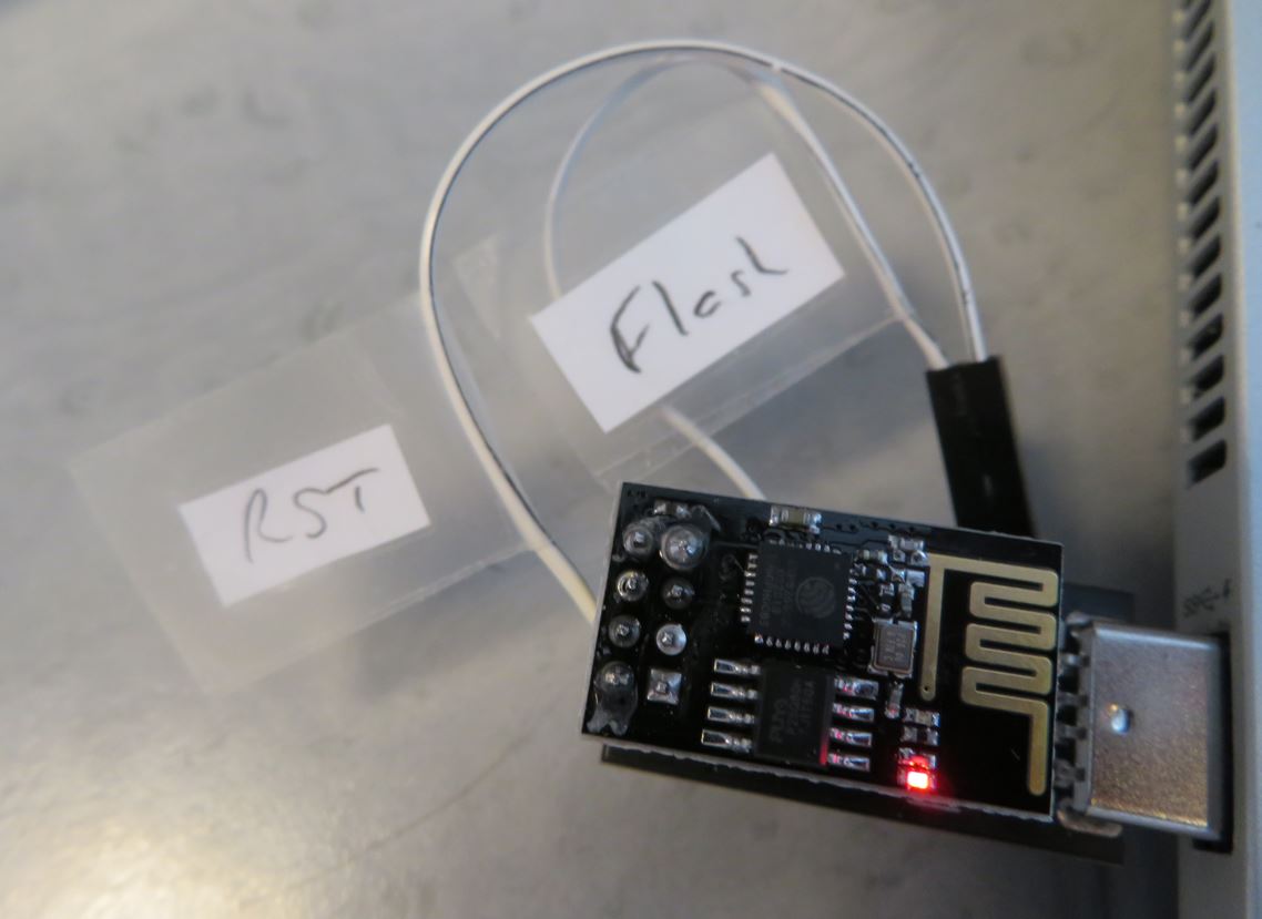

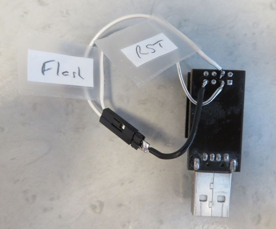

I am trying to download the firmware to have recent AT command support on my ESP8266 on ESP-01 .
To do that, I use USB->UART adapter (based on CH340C) which seems pratical (for UART communication and to power ESP8266 using USB) . Only one rework concerning Reset and Flash signal.

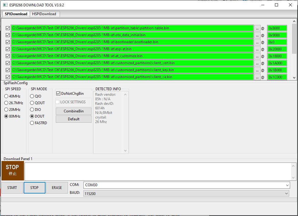

I am using flash_download_tool_3.9.2.exe and also version "esp8285-1MB-at" you adviced ( https://github.com/espressif/esp-at/act ... 1805278287 taken from "artfact" area) .
With the "ESP8266 Download Tools V3.9.2" , I have the following information of my board :
(I do manually : Flash & reset at GND , then after Start push , Reset is unplugged)
Flash vendor:
85h:N/A
flash devID:6014h
N/A:8MBit
crystal 26MHz
Then I have programmed the chip by following setup indicated in the package "esp8285-1MB-at" :
(I copy by hand all setting obtained in flasher_args.json into the GUI of the programmer)
        "0x8000" : "partition_table/partition-table.bin",
        "0x9000" : "ota_data_initial.bin",
        "0x0" : "bootloader/bootloader.bin",
        "0x20000" : "esp-at.bin",
        "0x18000" : "at_customize.bin",
        "0x1A000" : "customized_partitions/client_cert.bin",
        "0x1B000" : "customized_partitions/client_key.bin",
        "0x1C000" : "customized_partitions/client_ca.bin",
        "0x1D000" : "customized_partitions/mqtt_cert.bin",
        "0x1E000" : "customized_partitions/mqtt_key.bin",
        "0x1F000" : "customized_partitions/mqtt_ca.bin",
        "0x19000" : "customized_partitions/factory_param.bin"
Still from that flasher_args.json , I setup the programmer flash configuration : dout , 80MHz.
(No way to set the flash_size on the programmer GUI)
After have programmed the chip. I unplugged Flash pin and I unplug USB . (to power down)
Then I plug USB my UART->USB (power up) (Reset and flash signal unplugged).
I see that led ESP8266 ESP-01 stay blue . Then , no communication possible with my Uart console :o :shock: (Transmit CR+LF , Receive LF , 115200bps ,8bit data, no parity, 1bit stop) . That console configuration did work before firmware update.
Have you some ideas to help me to enable AT communication ? Is it something wrong regarding the programming of the chip ?
