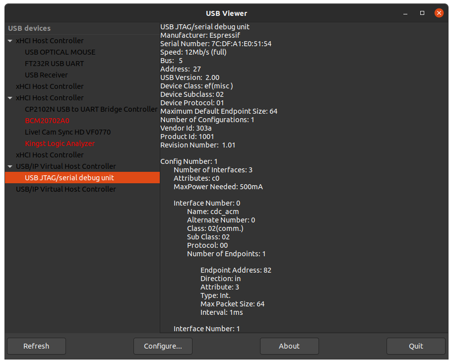

Yes, it is totally possible. I do have some early code, which is working with CDC, CP210x, HID etc, but there is some limitation thou (or just my code is not very good).Hey, thanks for your response, i am not sure if this is possible, but it would be cool.
For example CP210X/CDC based devkit cant be flashed, because device is disconnected for very short time. Maybe there should be implemented some mechanism that would reconnect device, but i think its not possible. I didnt do stress test yet, but with simple serial com it works for few hours without problem. Another problem i have so far is that only full speed device works. So, i have vireless keyboard and mouse with USB dongle, and this works, but wired keyboard is not working yet. I have only USB3 pendrive right now, and i cant make it works, because my linux MSC driver is trying to reset device after getting all descriptors and cant assign address to it.
I have to say i had a lot of problems to solve to get it work even if it seems to be easy protocol to implement.
Im not saying i will do it any time soon, but i would like to do a simple device that could intercept USB packets and display on simple website hosted on the same esp32, or maybe even on small server with use of UDP or WS, and make esp32 hardware USB analyzer.
esp32 running simple app, connected to another esp32 S3 running USB/IP

This is PoC code, which works with some simple USB devices, like serial etc:
https://github.com/chegewara/esp32-usbip-poc
