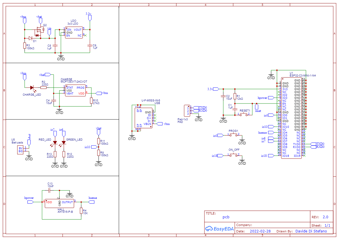

Hi everyone, I'm currently tryin to develop a custom board based on the super compact ESP32-C3-MINI-1-N4.
This is (or it should be, at least) an improved version of another board of mine, based on ESP32-WROOM-32 that was tested and working.
I wanted to make a smaller board, with USB charge functionality. Board programming should happen via RX/TX pins, I am using an external USB to TTL converter, that worked fine with the wroom board.
If you are wondering why am I not using USB to directly program the board by putting the converting onboard, it was a matter of size constraints that I had to follow. I know, having usb for power only is pretty dumb but hey, it is what it is :D this is just a proto board anyway.
What I'm experiencing here is a boot loop that does not let me program the board.
The power elements (load sharing P-MOSfet, USB charge circuit) comes from a Adafruit Feather board, while all the remaining elements are the same from the wroom board, which works perfectly fine.
I assembled both my boards with JLCPCB service, now that i got the C3 one i'm trying to upload my code but the loop is preventing me to do so. It's a 3.3V board.
I'm working in Arduino IDE
When I try to upload a basic test sketch I get connection failures
A fatal error occurred: Failed to connect to ESP32-C3: Invalid head of packet (0x**)
The serial monitor is simply spamming "invalid header: 0xffffffff" messages and restarts

Here is my schematic
I really have no idea of what's happening here, the WROOM board was fresh and working out of the factory.
Any help would be appreciated, thanks everyone.

So, em, the C3 has a built-in USB-to-serial-JTAG converter... you just had to hook up the data lines to GPIO18/19 pins and you would have a completely integrated programmer. May still be worth looking at for V2.
And you may need a V2, as the C3 uses GPIO9 to get into download mode, not GPIO0.Try to ground GPIO9 and try programming again, pretty sure that will work.

I do understand that i can't get into PROG mode with my current PROG button, but I still don't understand why the board is constantly resetting.

Your board looks similar to one I've created, the Rust Board.
This board uses the embedded USB for flashing and debugging. For the first time, you need to enter into BOOT MODE manually by the GPIO9 to GND (use a pulldown resistor!) and reset the C3. After that, you need to flash and manually reset again.
For the second time flashing, you don't need to do it manually anymore.
Please take a look at the schematics I shared and compare them to yours.

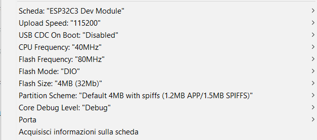

Are you able to program the board via Arduino IDE?

Yes. You need just to select the right option in the Arduino IDE menu.
USB CDC Docs

What do you mean with "v2"? I did not find multiple versions for the C3-MINI- module on JLCPCB catalog.
I mean V2, as in, version two of the board that you're going to make. (Assuming you're going to respin it instead of bodging the corrections in and calling it a day.)
There's nothing in your flash, but if GPIO9 is high, the ESP32 tries to boot from there anyway. So it tries, fails, then gets reset by one of the two watchdogs, tries again, fails etc.

Is my schematic that bad?

19:30:08.287 -> rst:0x1 (POWERON),boot:0x0 (USB_BOOT)
That is the wrong download mode... from your schematic, you haven't connected the other bootstrap pins (gpio2 & 8) to anything either. You want to have pullups on both pins. Try forcing them high and try again.

Yes, by pulling the bootstrapping pins correctly I managed to enter the correct download mode and flash a test sketch.
It worked, thank you very much! I won't forget to properly double check the datasheet ever again.
