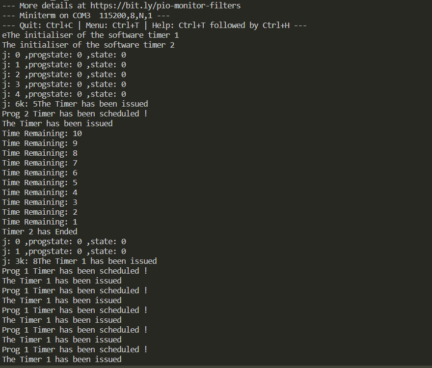

I was trying to learn about freeRtos but I've encountered a problem so I've decided to put up a program.
I am using platform IO
What I intend to do is this:
- We have 2 one-shot timers (I actually wanted to use more but tried with 2 after trying with 1)
- I wanted to define them as static.
- We have an eventhandler to specify when they should work (state = 1 for timer 1, state = 2 for timer 2)
- I want these timers to be stoppable at anytime (even if it doesn't reach the callback function) from another program
If I don't include the 2nd timer, the code works fine but when I include it some sort of problem occur
And also I haven't been able to use TaskScheduler the program always crashes.
Would be grateful if anybody guided me though this, thanks in advance.
What I've done so far is like below:

Below is the Serial message print outs:

I didn't examine it to closely for other issues, but your problem is that your using the variable progState for both timers which is what is causing the problem.
You also need to add a delay in loop() or your going to cause the watch dog timer to panic.

    Serial.println("The initialiser of the software timer 2");
uint16_t timeVacuum = 14;
uint16_t timeAir = 10;
uint8_t relay1Pin = 2;
void setup() {
  while (!Serial){}
  Serial.begin(115200);
  pinMode(relay1Pin, OUTPUT);
//  DmdTimeStart();
  progTimerSet(timeVacuum, timeAir); // Setting up the FreeRtos Software Timers
void loop() {
  if (state == 1 || state == 2) {relay1Control = 1; digitalWrite(relay1Pin, HIGH);}
  else if (state == 0) {relay1Control = 0; digitalWrite(relay1Pin, LOW);}
  if (state == 0)
    vTaskDelay(pdSECOND);
    Serial.print ("j: ");
    Serial.print (j);
    Serial.print (" ,progstate: ");
    Serial.print (progState1);
    Serial.print (" ,state: ");
    Serial.println (state);
    j++;
    k++;
  if (j == 5)
    j++;
    Serial.print (j);
    Serial.print ("k: ");
    Serial.print (k);
    state = 2;
  if (k == 7)
    j++;
    Serial.print (j);
    k++;
    Serial.print (k);
    state = 1;
  progTimerEventHandler(state);
  delay(1);

Postby Hailwiz9 » Mon Apr 11, 2022 7:20 pm
Code: Untitled.c Select all
void progTimerEventHandler(uint8_t state)
// State == 1 conditions
if (state == 1)
if (progState == 0)
if( progTimer1 != NULL ) // If the timer has been created
progTimer1Started = xTimerStart(progTimer1, 10); // Starts the timer
Serial.println("The Timer 1 has been issued");
remTimeDisplay1 = ((xTimerGetExpiryTime(progTimer1) - xTaskGetTickCount())/pdSECOND);
if (progTimer1Started == pdPASS)
progState = 1;
Serial.println("Prog 1 Timer has been scheduled !");
if (progState != 0)
remainingTime1 = ((xTimerGetExpiryTime(progTimer1) - xTaskGetTickCount())/pdSECOND);
if (remTimeDisplay1 != remainingTime1)
remTimeDisplay1 = remainingTime1;
Serial.print("Time Remaining: ");
Serial.println((int)remainingTime1 + 1);
// State == 2 conditions
if (state == 2)
if (progState1 == 0)
if( progTimer2 != NULL ) // If the timer has been created
progTimer2Started = xTimerStart(progTimer2, 10); // Starts the timer
Serial.println("The Timer has been issued");
remTimeDisplay2 = ((xTimerGetExpiryTime(progTimer2) - xTaskGetTickCount())/pdSECOND);
if (progTimer2Started == pdPASS)
progState1 = 1;
Serial.println("Prog 2 Timer has been scheduled !");
if (progState1 != 0)
remainingTime2 = ((xTimerGetExpiryTime(progTimer2) - xTaskGetTickCount())/pdSECOND);
if (remTimeDisplay2 != remainingTime2)
remTimeDisplay2 = remainingTime2;
Serial.println((int)remainingTime2 + 1);
if (state == 0) {progState = 0; progState1 = 0;}
if (state != 1 && progTimer1Started == pdPASS)
{ xTimerStop(progTimer1, 100); progState = 0;}
if (state != 2 && progTimer2Started == pdPASS)
{ xTimerStop(progTimer2, 100); progState1 = 0;}
When I changed to code as shown above it started to work, thanks for your guidance.
