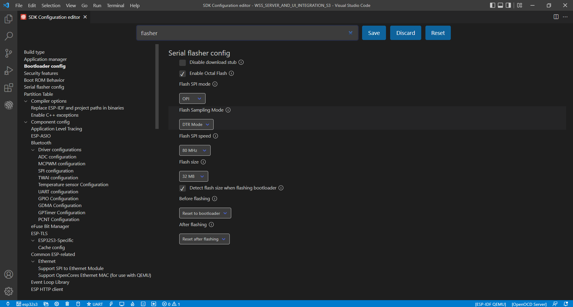

You selected 4MiB of flash in menuconfig (under serial flasher options iirc) but you have 32MiB of octal psram. The app will pretend thlat there's only 4MiB installed.
I set to 32MiB in menuconfig.
I have two files inside root project directory.
Sdkconfig and sdkconfig.old
Will esp-idf be using the sdkconfig.old file ?

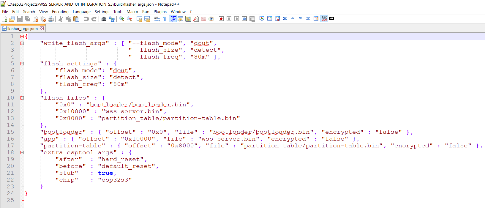

Did you make sure that ESPTOOLPY_FLASHSIZE_DETECT (Serial Flasher config -> Detect flash size when flashing bootloader) is disabled ? It is usually enabled by default. This will override any user defined flash size.
The visual studio code extension uses the project's build/flasher_args.json file for esptool flashing arguments, which are set by sdkconfig values.
Baldhead
Posts: 515
Joined: Sun Mar 31, 2019 5:16 am
Location: Brazil
Re: Boot esp32-s3-wroom-2 doubts
Postby Baldhead » Wed Apr 27, 2022 11:20 pm
@ESP_bignacio,
sdk_config and flasher_args.json image in annex.
Dout mode is only for flashing the program on esp32-s3, correct ?
In "running" mode the esp32-s3 flash memory communication is octal, correct ?
"flash_mode": "dout" in file flasher_args.json.

Disable that 'Detect flash size when flashing bootloader', and see if that helps, please.
Baldhead
Posts: 515
Location: Brazil
Postby Baldhead » Thu Apr 28, 2022 9:55 pm
I disabled the 'Detect flash size when flashing bootloader' and the sha error and flash size error disappeared.
Shouldn't it work with 'Detect flash size when flashing bootloader' enabled ?
There must be some bug, right ?
