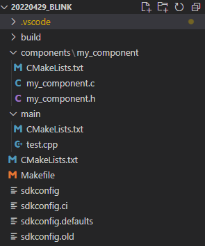

Hello, I'm facing a problem when I try to compile my basic CPP project with a component written in C but it failed to build.
Previously I was using Platform IO environment but recently I switched to esp-idf (version 4.4.1) environment. This will come with new opportunities and challenges. What I’m trying to do is making my own esp32 project with C++ (not C), and make use of some external C components. The problem is that the linker, not the compiler, can’t build my solution. The Espressif Build System with CMake is new for me and I guess that I do something wrong here. I've made the code as small as possible to get it back to the essence of the issue. Could anyone tell me what I’m missing here?
The error is as follow:
in function `app_main': …main/test.cpp:6: undefined reference to `say_hello()' collect2.exe: error: ld returned 1 exit status
CMakeLists.txt
cmake_minimum_required(VERSION 3.8)
set(CMAKE_CXX_STANDARD 17)
set(EXTRA_COMPONENT_DIRS src include lib components)
include($ENV{IDF_PATH}/tools/cmake/project.cmake)
project(test)
main\test.cpp
/* main program */
#include <stdio.h>
#include "my_component.h"
extern "C" void app_main(void) {
    say_hello();
    printf("app_main\n");
main\CMakeLists.txt
idf_component_register(SRCS ${srcs} "test.cpp"
                        INCLUDE_DIRS ${include_dirs} "."
                        REQUIRES my_component)
components\my_component\my_component.c
#include <stdio.h>
void say_hello(void) {
    printf("Hello CPP\n");
components\my_component\my_component.h
void say_hello(void);
components\my_component\CMakeLists.txt
idf_component_register(SRCS "my_component.c" INCLUDE_DIRS ".")
link to all project files:
20220429_blink.zip
(20.96 KiB) Downloaded 381 times
