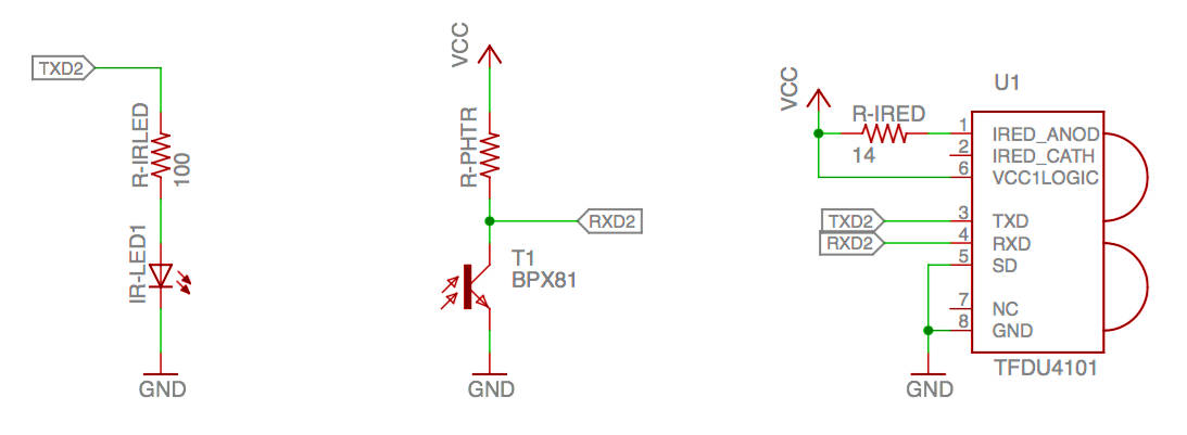

The awesome ESP32 has IrDA support, but how to wire it ? (I can't find any Docs nor further Information about that)
Does it need an "Infrared Encoder/Decoder" (like an MCP2120 with additional Crystal) and a "Infrared Transceiver Module" ?
Or can the ESP32 directly generate the IRTX and decode the IRRX so just a IR-LED and a IR-Phototransistor is needed ?

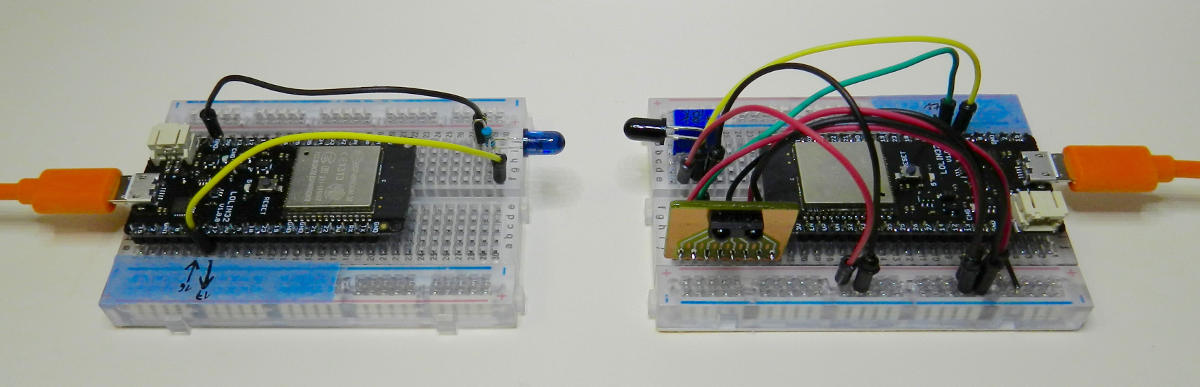

Yes! I figured it out, it's working with just a few additional parts and only 2 Bits to set.
I have a "WEMOS LOLIN32" Board, others are similar but Pin numbers may vary.
For "send only" with Arduino IDE:

And just a Infrared-LED and a Resistor ! That's it !

It works with just a Phototransistor and a Resistor !
But use a "Infrared Transceiver Module" (like TFDU4101), that contains a Amplifier, Comparator, some Logic and a Driver for better results.

I tried it first without any IrDA Code, just a wired serial connection with 5V TTL Levels. (Cross Rx->Tx and vice versa)
As that worked, I set it up with a normal LED to see if there is some activity, then I checked it with an Oscilloscope.
Then I set up the IR-LED with R1 = 100 Ohm and R2 = 4.9 k Potentiometer and connected the Oscilloscope to RXD2 and turned the Poti till I got a good signal and then the Data came through over IR :-)
I bought all Boards at once from the same Version and still use them, so I don't know any changes.
Hope that helps !

There is no Library, it's all in Hardware. A Hardware UART that can switch into IrDA Mode by activate the Bit's in the Register.
Got it to work from 5mm up to 3 m with 3.3 Volt and up to 4 m with 5 Volt on the TFDU4101.
