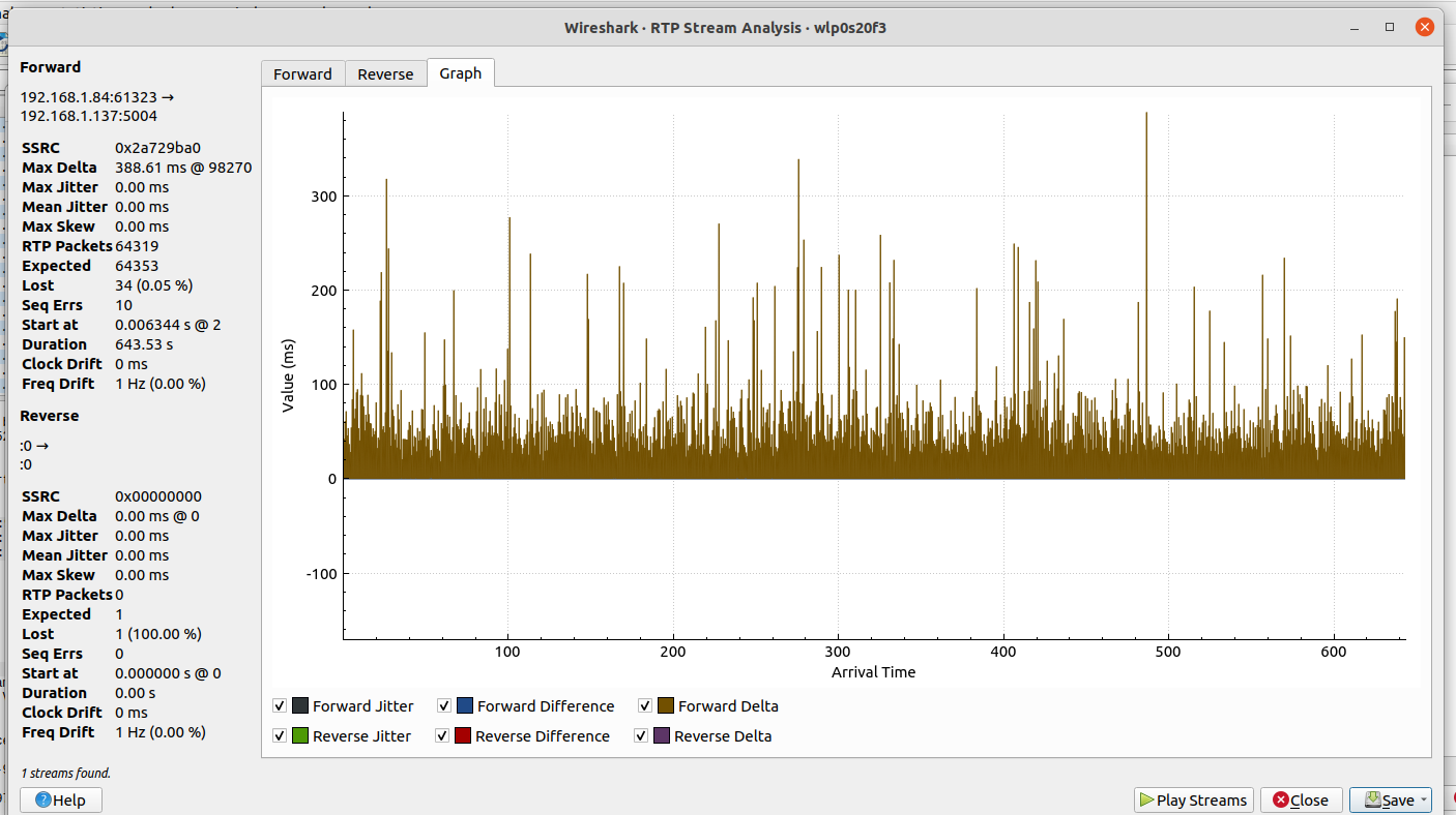

I'm seeing some significant delays in the delivery of UDP packets from the esp32s3. I have testet this in two different wifi environments/networks using wireshark (see below)
The graph shows time between consecutive UDP packets (with encapsulated RTP packets).
Noisy wifi environment
The esp32 is placed close to the AP.
Here the biggest measured delay is 388ms, but I have mesured up to twice that, delays often hits between 200-300ms as seen.

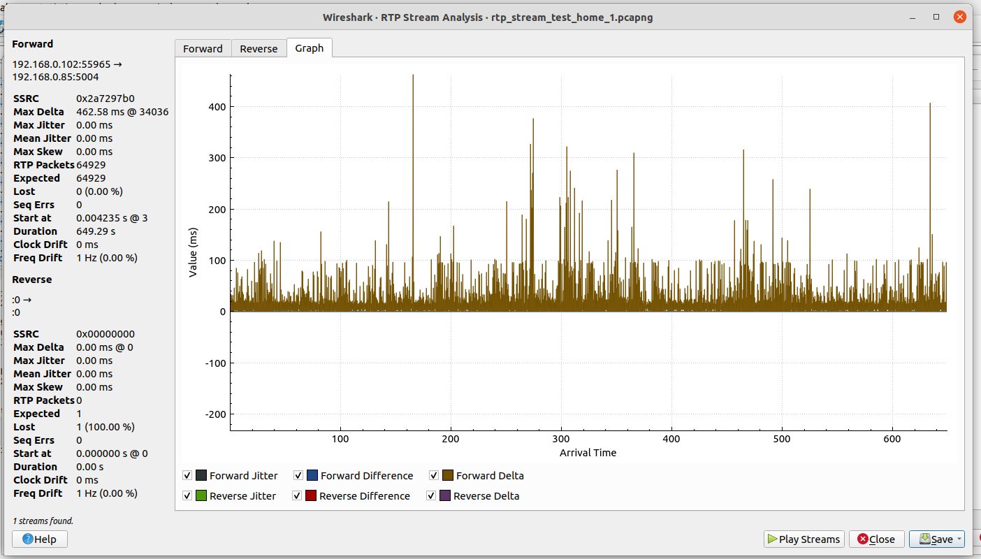

Less noisy wifi environment
Esp is further away from AP
Measuring up to 462ms here, though most are below 100ms. Delays again often hit between 200-300ms.
Screenshot from 2022-05-06 09-40-07.png (208.62 KiB) Viewed 10147 times

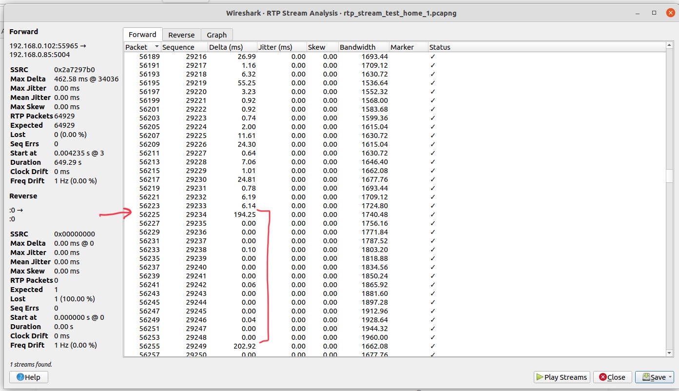

The packages seems to be lumped together when leaving the esp (or elsewhere in the network?) when there has been a big delay.
Packets 56225-56253 (15 packets - others are fragmentation packets) arrive at the laptop at the same time after a delay of 194ms. The esp is set to send every 10ms.
screenshot from 2022-05-06 09-50-56.jpg (260.7 KiB) Viewed 10147 times

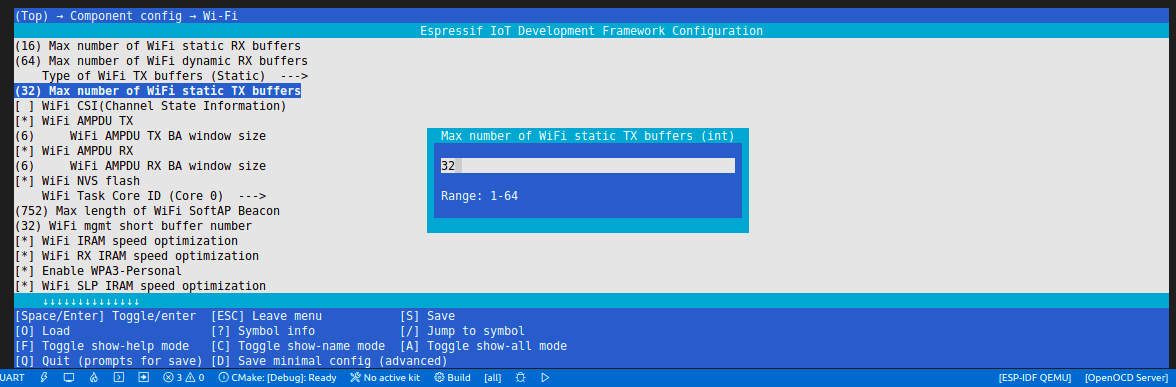

I can set the dynamic buffers to 128 no problem, but I would very much like them to be static for performance reasons, and as large as possible. Menuconfig says range: 1-64
Screenshot from 2022-05-20 13-23-50.png (82.36 KiB) Viewed 9822 times

I have now tried with an ESP32-S3-DevKitC-1-N8R8 with 8MB of PSRAM and I still can't set the static wifi buffer to more than 32 without it crashing at boot.
Can you point me in direction of someone who has deep insigt into the esp32 WiFi stack?
