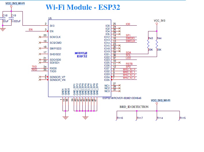

We are facing issues of ESP32 not getting programmed. While programming through espflash.py tool we are getting error " MD5 of file does not match data in flash! .
We checked further and found below observations :
1. Voltages of OK Modules and Failed Modules are compared. It is observed that Failed modules PIN No. 14 is showing 3.3V and other Pin No. 13, 17, 18, 19, 21 of ESP32 modules are showing 1.8V. Whereas OK Module voltage at Pin no. 14 is 0.
2. Pin No 14 is MTDI, i.e Boot Strapping Pins. This pin decide Voltage of Internal LDO (VDD_SDIO)
If MTDI pin is at logic low then internal regulator is configured for 3.3V supply, if MTDI pin is at logic high then internal regulator is configured for 1.8V
3. Pin No 14 is responsible to power internal SRAM and ROM. As per datasheet "ESP32-Wrover-IB" modules internal regulator works on 3.3V.
Datasheet Comment:
• Internal pull-up resistor (R9) for MTDI is not populated in the module, as the flash and SRAM in ESP32-WROVER-B
and ESP32-WROVER-IB only support a power voltage of 3.3 V (output by VDD_SDIO).
3. Now we are not sure why this happens need help here. In our schematic MTDI Pin is not powered externally. Below are the logs of failed modules.

What hardware are you using; are you sure that pin is not shorted by e.g. bad soldering? One way to 'fix' this is to use espefuse.py to force the correct flash voltage; that way it's not dependent on the electrical state of GPIO14 anymore.

Re: ESP32-Wrover-Ib || MD5 of file does not match data in flash!
Ah, sorry, my bad, I mean GPIO12 which is pin 14. You can burn efuses using espefuse.py; it comes with your esp-idf installation.

Thanks, we are able to flash the FW successfully after running the espefuse.py script.
Please confirm after running this script is there is any change in functionality/features of the module?
Nope, functionality should be the same. But it does strengthen my conviction that your GPIO12 (pin 14) is shorted to some other pin... I'd really look into that if you have more of these errors; it could mean that e.g. the solder paste profile used for the chip is wrong.
We double check all the fail boards for SMT defects but no SMT defects found. Thanks again to help us in recovering the fail modules.
But still on daily basis we are getting same failure in modules (2~3 Nos.) out of 600 device production.
Need support for finding root cause for this issue.
Further shall we use the espefuse.py script on all production boards? or only on fail boards.
There's nothing wrong with running the espefuse.py script to fix the flash voltage on boards like this; people do it in production if they need to use GPIO14 for something where the boostrap behaviour interferes, and it's perfectly acceptable to run it on all boards. It's still a bit strange that GPIO14 is pulled down like that on some of your boards, though.

Hello ESP Team,
We have observed that there is voltage difference after running the ESPEFUSE.py script. Please check the attached comparison sheet. Voltages are compared with respect to programmed ESP32. Changes in voltage are observed in pins : 4, 5, 10, 13, 28, 29, 30, 31, 32, 34.
Please refer to the attached comparison sheet.
We need clarity on these change in voltage values, although these pins are not used in our circuit. Is there any issue in the internal circuit.
