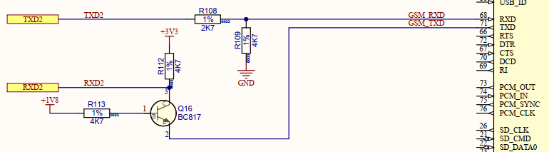

I'm using the We are using a ESP32-S3-DEVKITC-1-N8 with the uart connected to a SIM7600E.
I can see the TX from the ESP on the RXD of the SIM7600, but we see a signal on the ESP RX as follow:
The min is 2.84V.

You have a voltage divider and level shifter in that schematic as if the ESP32-S3 were an 1.8V part. The ESP32-S3 is not an 1.8V part, so I'm scratching my head on why those components are there. Is the SIM7600 1.8V and you accidentally put the level shifting logic in backwards?
Re: ESP-S3 Uart
Posted: Wed Jun 01, 2022 9:33 am
by Douglas-EDM

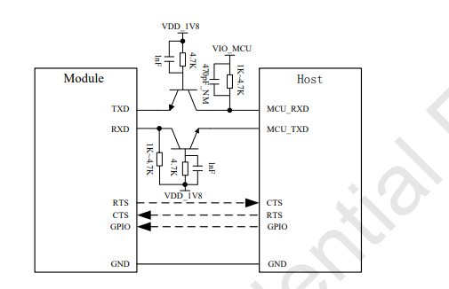

Hi, I apologize for the unclear schematics. The IC on the right is the SIM7600.
The SIM7600's UART is 1.8V.
For the TX of the sim7600 to the RX of the ESP we used the voltage level shifter as per the SIM7600 datasheet:
lvl shift.png (25.38 KiB) Viewed 7508 times
The problem is that the low bits to the ESP only pulls down to 2.8V instead of 0V while the high bits are at 3.3V as it should.
We had a previous issue as well where GPIO0 didn't pull down to 0V but instead remained at 2.8V while setup as in input (we haven't resolved that yet as we could use another pin).
