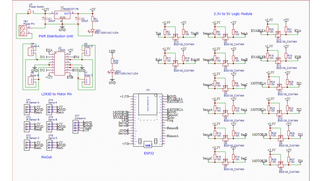

I've got a problem where I'm testing my external board esp32 only using blinking led code, but the serial monitor shows it keeps rebooting after I connect esp32 to the external board. Does anyone know what happen? What makes it keep rebooting?
I attached the circuit diagram of my external board below

What does your serial output say specifically?

This is the error message I got
Re: Code keep reboot after ESP32 connected to external board
Posted: Wed Jun 08, 2022 7:44 am
by Sprite
Warning: Could not auto-detect Flash size (FlashID=0xffffff, SizeID=0xff), defaulting to 4MB
That is not a good sign; means the ESP32 cannot communicate with the onboard flash. Does the devboard also do this when it's not in your PCB? If not, check if there is something shorting pins 16-18 or 20-22 to something; those pins must all be not connected.
