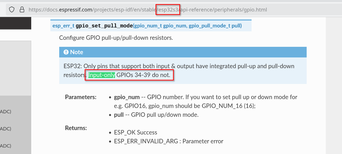

Thanks for the clarification...but the docs still say "input only" in 2 places on this page (one shown here):
https://docs.espressif.com/projects/esp ... /gpio.html

Okay, it seems we can't trivially fix this as these docs are generated from the header files. We decided on the 'ESP32:' bit to indicate this only goes for the original ESP32 chips.
