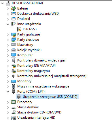

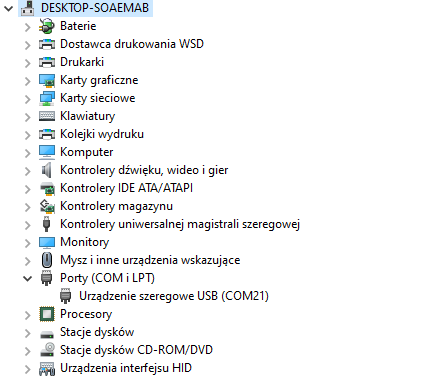

I dont understand how can you say that nobody solved it yet, when i clearly said few times and also included pictures from windows proving it is working:
https://esp32.com/viewtopic.php?f=12&t= ... =20#p95651
Yet again, there is official espressif documentation about using zadig under windows:
https://docs.espressif.com/projects/esp ... ndows-only
If its not clear maybe its good to ask to update it.
Another prove is here. This is windows in VM, the only connected USB device is esp32-s3. As you can see 2 devices are detected, esp-s3 not recognized and com19, serial port. This is device with USB_PHY_SEL burned
And here is another esp32-s3 without USB_PHY_SEL burned. As you can see only serial port com21 detected:

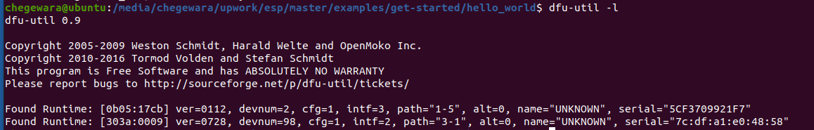

On linux it looks like this. Differently detected S3 with and without burned efuse and only 1 is detected as DFU capable:
