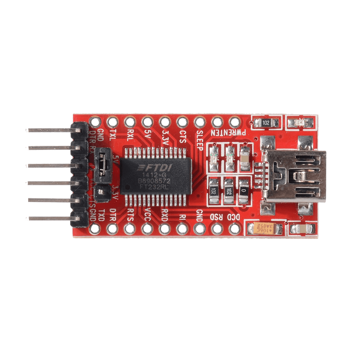

This happens when I connect to USB-TTL after I connect on-board power. If I am connecting the USB-TTL adapter first and only then powering the board it works fine until the next reset (even if I take out USB-TTL out)
I know that my code isn't starting because it logs at 57600, while this message appears at 115200.
Is there anything else that I'm missing?

P.S. - I am using Arduino IDE with ESP32 core and this USB-TTL (see picture attached)
