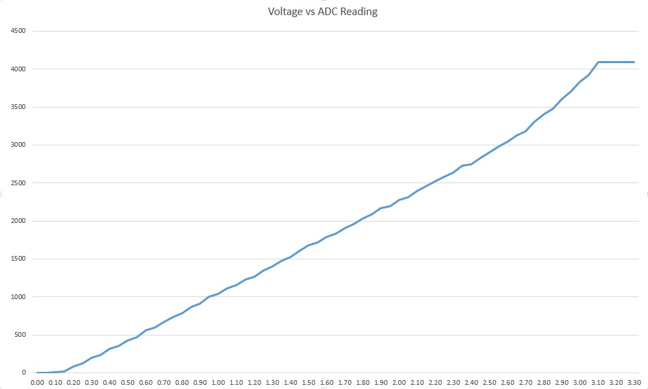

I have been trying and failing to get a NodeMCU ESP32-S Dev board to properly read two analog inputs (voltage). It appears the inputs are very non-linear and there is a good amount of noise.
I'm am using the following board for my testing; https://www.amazon.com/gp/product/B0718T232Z/
I have downloaded the firmware repo, built the firmware, and flashed it two days ago so I should be running up to date firmware.
I am using a known good voltage output (which I can set to whatever value) along with testing the voltage to verify its correct.
With the above said I went through and mapped out the voltage vs ADC value and what I found was under around 0.1 v the ADC didn't see anything and above around 3.08v the ADC just reads 4095. I've attached the data and here is the graph:
Based on this I'd like to try to switch to the -6db attenuation and also the 11 or 10-bit width and retest. However I don't know how to do this. I can fiddle with Arduino but I can't seem to get the commands right and I'm wondering if I even can from there. I'm assuming I can change the default from the -11db and 12-bit somewhere in the source code and recompile the firmware and reflash it but again I'm not sure how to do that.
Can anyone guide me on the changes I need to make to either add something to my sketch to change these settings on a entire ADC or pin by pin basis or what to change in the firmware code?

What a coincidence! That's EXACTLY the same ESP32 I use. I've got two, they work perfectly (so far?)
Width:
* Set the resolution of analogRead return values. Default is 12 bits (range from 0 to 4096).
* If between 9 and 12, it will equal the set hardware resolution, else value will be shifted.
* Range is 1 - 16
* Note: compatibility with Arduino SAM
void analogReadResolution(uint8_t bits);
* Sets the sample bits and read resolution
* Default is 12bit (0 - 4095)
* Range is 9 - 12
void analogSetWidth(uint8_t bits);
Attenuation:

So thats the bad part. It seems that adding the code to my Arduino sketch had zero effect on the controller. The width stayed at 12bit and the attenuation at 11db. Exact same results from my testing also, like the values were the exact same (within 20) no matter the setting which tells me it wasn't taking it. Unless I'm doing something wrong. This is what I tried in order using the defaults for the first test to verify nothing changed:
void analogSetWidth(uint8_t bits = 12);
void analogSetAttenuation(adc_attenuation_t ADC_11db);
Same results as initial testing (without those lines). Then tried:
void analogSetWidth(uint8_t bits = 11);
Again same results. Then tried:
void analogSetAttenuation(adc_attenuation_t ADC6db);
Expecting the max voltage to be 2.7 per the documentation. But it wasn't....it was still 3.3 (well 3.1 ish) and the ADC still scaled the same. Finally tried:
void analogSetAttenuation(adc_attenuation_t ADC_6db);
And again didn't change anything.
Am I doing something wrong or is it ignoring the commands? I didn't use void analogReadResolution(uint8_t bits); yet but I'm assuming if the attenuation command was ignored that would be too.

Those calls seem to work for me. Note: there's been plenty of discussion of non-linearity of the ADC.
See:

Maybe you can learn a bit of C, for example how to call a function instead of just declaring it?....I'm not sure what else I can try.
Here is a stripped down version of what I used to test the ADCs (I've not tested if it works in this minimal version):
int n = 0;
void setup()
Serial.begin(115200);
analogSetWidth(10); // 10Bit resolution
analogSetAttenuation((adc_attenuation_t)2); // -6dB range
void loop() //ADC Test
int av = analogRead(2); // ADC12 on GPIO2
for(n=1; n<8; n++) av += analogRead(2);
av /= 8;
Serial.print(" ADC12 = ");
Serial.println(av,DEC);
delay(200);
