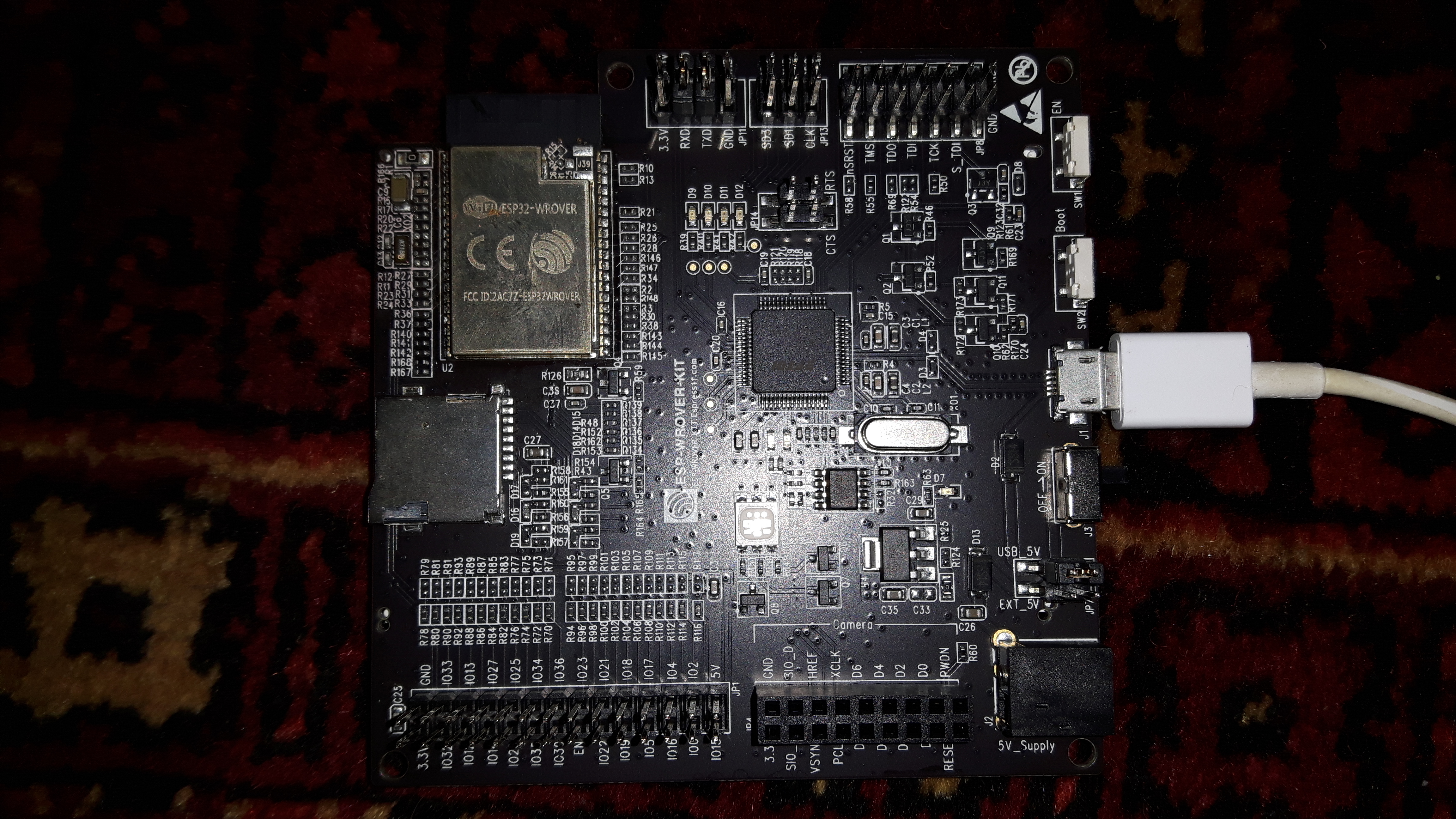

Can you post an image of your board so we can see the jumpers? Just want to check if there's something off there.

Here is an image with the jumpers:
Spend quite some time trying to get this to work.
What am I missing?

Re: WROVER-KIT-V2 programming problems - Non-responsive board
Posted: Sat Jan 27, 2018 1:18 am
by WiFive
Are you using a known good USB cable? Can you test another computer? You other boards probably use CP2102/4 whereas this board uses FTDI

by Cellie
Just did a clean install Arduino IDE on my Windows7 laptop.
Followed the install guide.
Everything went well except the board is not recognized.
I guess it must be a faulty board in some way because I did not get a beep from the wrover board.

by Cellie
I am happy to report that my replacement board works as expected.
Thanks to all for replying.
