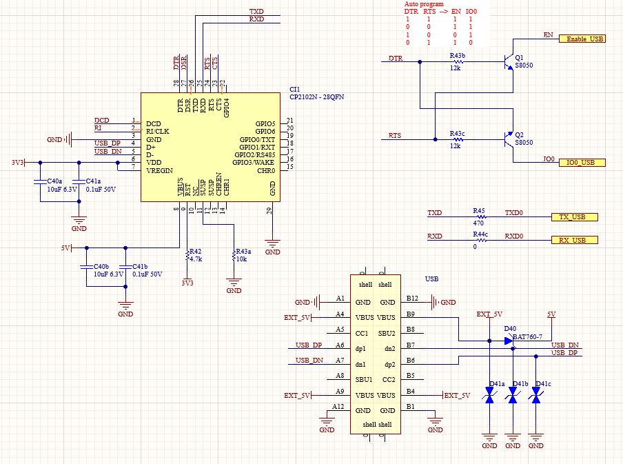

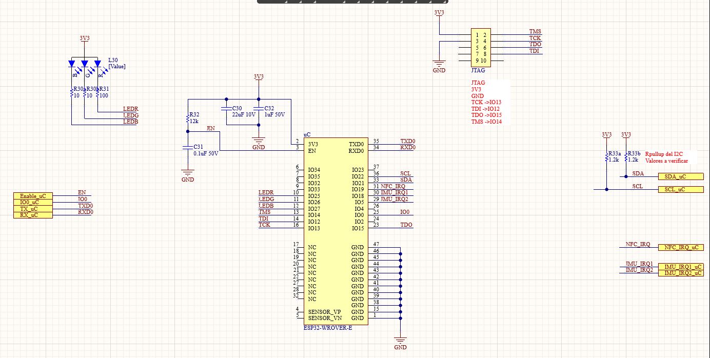

My name is Jose and this is my first PCB using ESP32, USB type C and USB to UART programing on board. :shock:
I make this PCBs using a Chinese supplier and I don’t know if there is something wrong whit the PCBs or whit my hardware design.
I am using the Visual Studio Code + Platformio for design the soft and programing the ESP.
The schematics and error are attach to this post.
There are 2 differences between the schematics and the real PCBs.
One is the addition of two R in CC1 and CC2 of the USB, I put two resistors of 5,1kohms between this pins and GND.
The other is a 10uF capacitor in parallel to the C31 because I read in some forums that this can help to get in the boot mode of the ESP32.

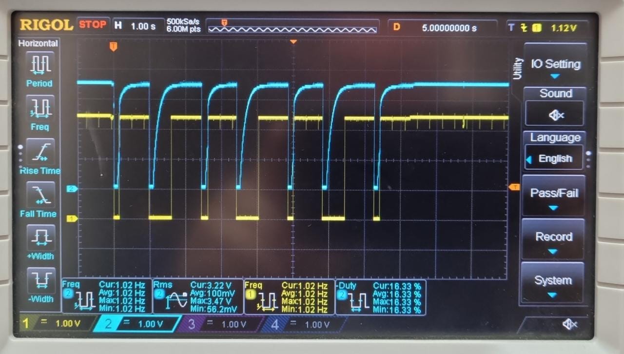

And this are the signals.
The yellow its the IO0 and the blue its the EN, all refered to the schematics.
WhatsApp Image 2022-08-23 at 3.18.14 PM.jpeg (110.43 KiB) Viewed 3489 times
This signals apear when i try to upload the code to the ESP.
The error as you can se abobe its "A fatal error occurred: Failed to connect to ESP32: No serial data received."
I don’t know if the fault it’s from the hardware or what.
Can anybody help me?
If I forgot to say something :roll: or do you need any other data to understand the problem please let me know.
Thanks

You have the TX of the USB-serial going to the TX of the ESP32; same for RX. These should be swapped: TX should go to RX and RX should go to TX.
