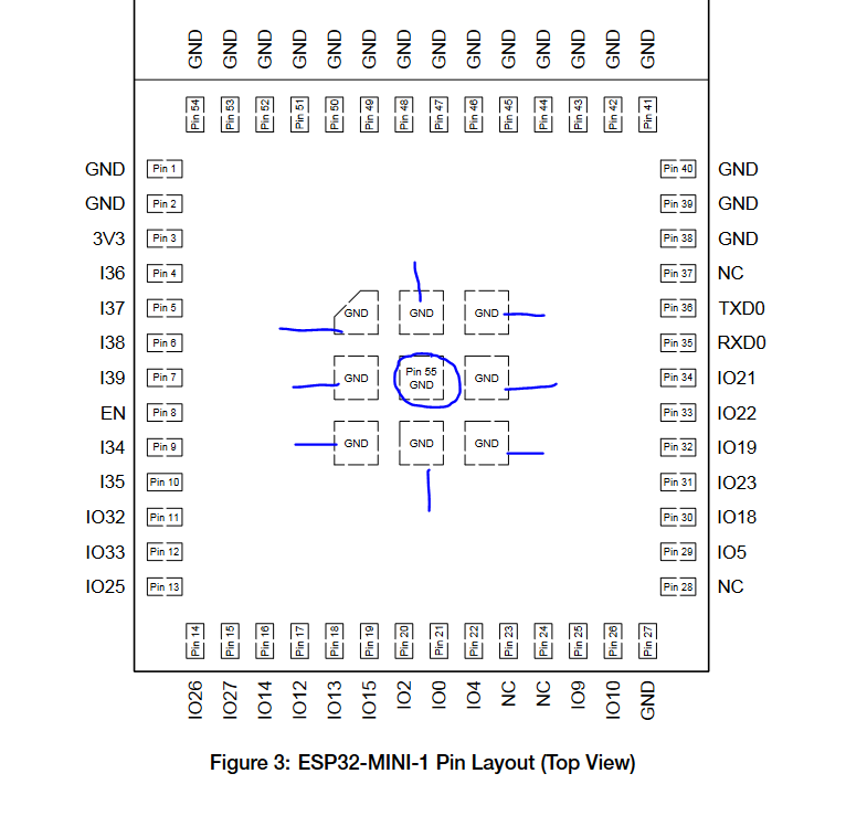

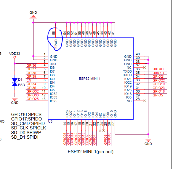

I need one help please.
In ESP32-MINI-1-N4 I see that there are additional 8 pins which are mentioned as GND but in schematic given in module datasheet they have connected pin55 only GND and not others so please suggest what to do of those all additional pins should connect all of them to GND OR connect only pin55 with GND and keep others NC.
Should I cover all of them into schematic symbol as well because in schematic i see only pin55 is covered?
Please see attached images for reference.
Thanks,
Brijesh K
Thanks,
Brijesh K
