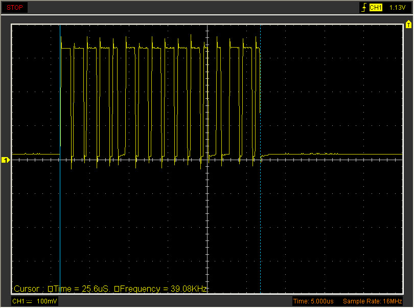

Here is the result with dezooming progressively:
With a 5us division, we see the signal is OK:

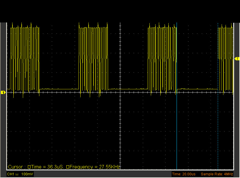

With 20us division, we see that we have 35us between frames. I expected less than 10 (delay of 1us and the computing takes 7us). It can be reduced to 20 with setting wait_tx_done to 0 for rmt_write_items :

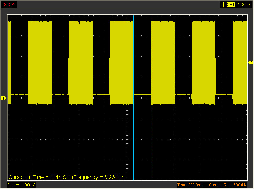

With 200ms division, we see a huge delay of 144ms! :
So the questions I have this time are:
-What is causing that delay between frames and the huge delay of 140ms?

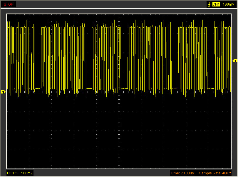

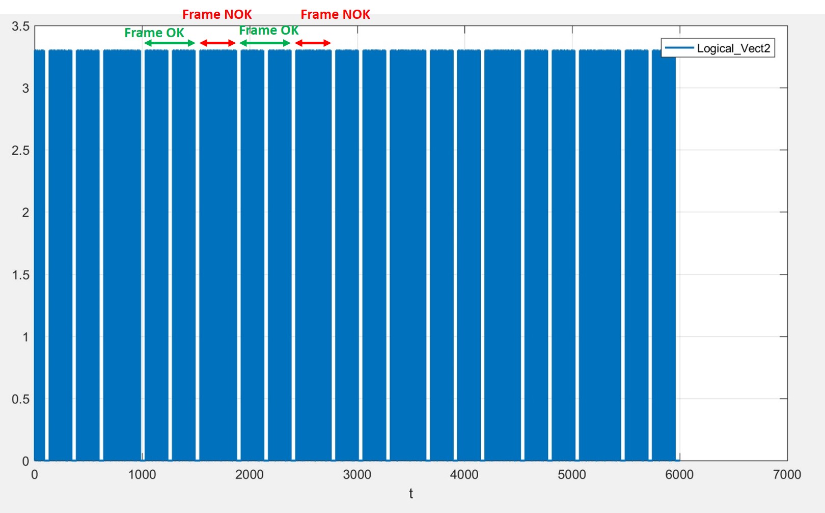

thx again for your answer ESP_igrr, I tried the loop mode, it now works a lot better without the 144ms delay and with a correct delay of 6us between frames which is excellent. This is exacttly what I need for my use!
I've got only one problem remaining:
-With random frequency, frames longer than 16 bits are visibles. Perhaps a kind of concatenation of several parts of 16 bits frames (it can be 24 or more bits). Maybe I 'm not calling rmt_write_items at the right time or something like that. The frequency of these longer frames depends on the delayMicroseconds I use in my loop() fonction so it seems like a synchronization problem:
...more in detail:
Frames_longer_than expected.jpg (133.17 KiB) Viewed 19134 times
I posted the code I use. The only thing it does is converting the throttle 1983 into a compatible 16 bit dshot frame. It then compute an timing array for RMT and write it:
