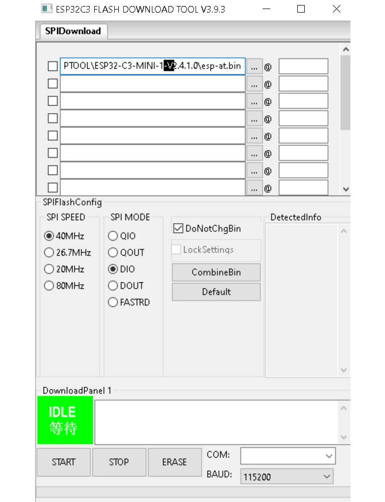

I want to use an ESP01-C3 as in the above link for Bluetooth connection to Android ( BT Classic) from an Arduino.
As it comes there is no BT support and you get the "Bluetooth is not enabled! Please run `make menuconfig`" message which it took me some time to track down as to the best way for an Arduino user (i.e not IDF) to correct.

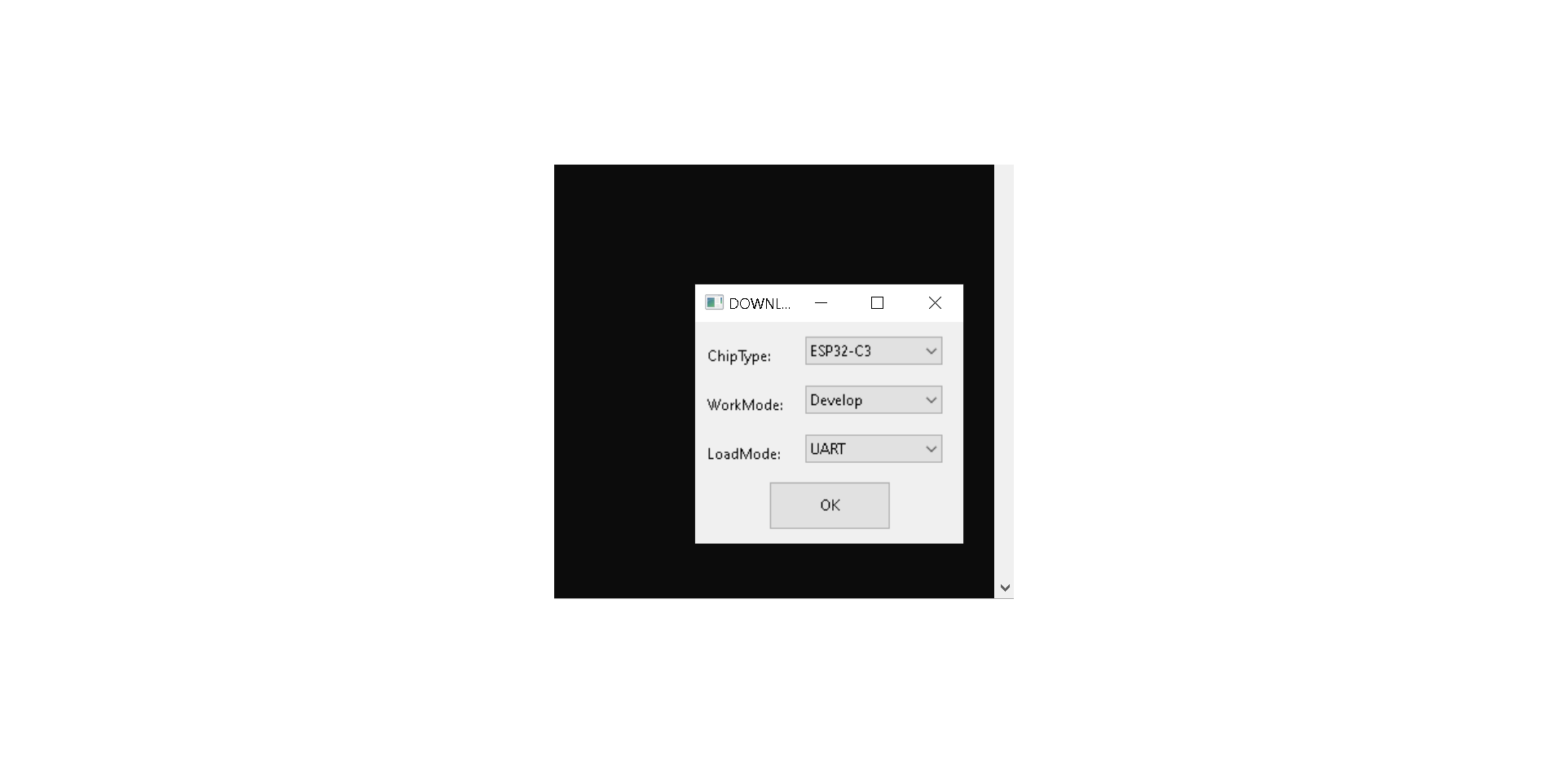

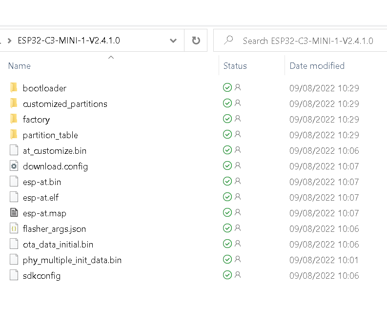

After much searching I believe that an answer is to use the ESP Download and download the correct .bin . I apologise if this is explained within the documentation, I am a bit nervous about not using the correct files and bricking it so would like confirmation please that everything looks ok before pressing start. Do I also have to download Boot and Factory files as well?
I'm also unsure about determining the SPI download parameters, do these look OK?
Thanks
Steve

i'm afraid that AT firmware for ESP32-C3 just supports Bluetooth® Core Specification Version 5.0, does not support BT Classic.
more details are in https://docs.espressif.com/projects/esp ... mands.html
About download guide, please browse https://docs.espressif.com/projects/esp ... guide.html for more details.
