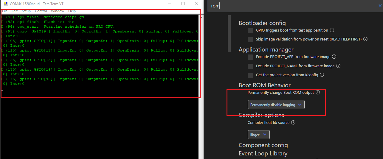

I need help to be able to read and write the efuse UART_PRINT_CONTROL.
This eFuse is responsible for sending booting messages using UART0 at startup, but I have a printer conected on Uart0.
I used the following code to read this eFuse, but ESP-IDF crashes on PANIC.
I would be very grateful if anyone can help
Regards

Why don't you just change it in menuconfig ?

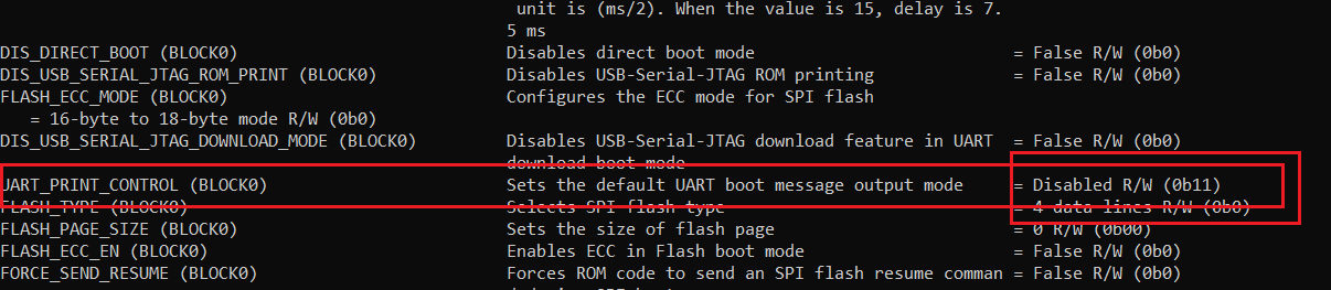

In MenuConfig when set "Permanent disable logging", still have messages on Uart0.
After displaying eFuses values using "espefuse --port COMx summary", I see UART_PRINT_CONTROL -> DISABLED (b11)
But even disabled, Uart0 displays some messages on UART0
Regards
