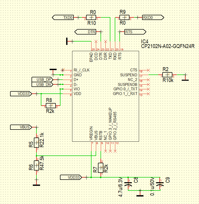

Hej all,
I desinged my own PCB based on ESP32-WROOM32E-H4. The schematic should be the same as on https://docs.espressif.com/projects/esp ... vkitc.html (ESP32-DevKitC V4 schematics (PDF)).
I use the USB bridge chip: CP2102N-A02-GQFN24R. As I see it my design and the reference linked above only differ in the boot button.

In Windows device manager I can see the USB bridge on COM12. Driver installed, working fine.
In Arduino IDE or VSCode I can choose COM12.

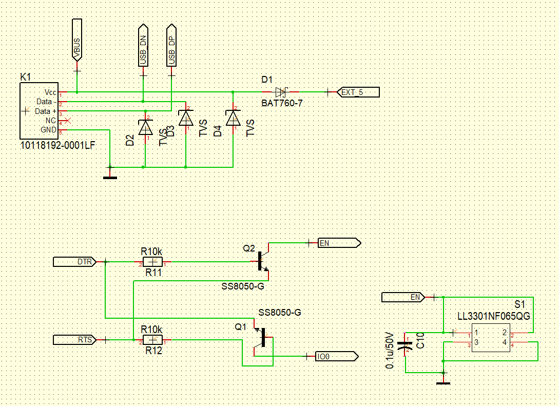

On the oscilloscope I can see:
- a data stream arriving at the ESP module pins.
- EN and IO0 going low and high
Arduino IDE says:
esptool.py v4.2.1
Serial port COM12
Connecting....................................
A fatal error occurred: Failed to connect to ESP32: No serial data received.
VSCode says:
esptool.py v3.1
Serial port COM12
*** [upload] Error 2
What is wrong? Auto boot circuit? Wrong capacities?
Connecting IO0 manually to GND with a cable dont work as well.
The bought DevKit works perfectly by the way. Without pressing any buttons.

My schematics for the USB connection:
ESP32 own PCB cant connect to ESP32
