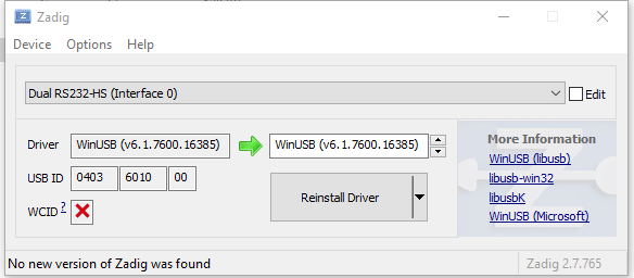

I am using ESP-Prog on a Windows machine.
I am using an ESP-Prog hooked into a HUZZA32 Feather (https://www.adafruit.com/product/3405) on a breadboard.
SIGNAL: ESP-PROG -> HUZZA32
MTCK: 4 - MTCK -> 13 - MTCK
MTDI: 8 - TDI -> 12 - MTDI
MTDO: 6 - TDO -> 15 - MTDO
MTMS: 2 - TMS -> 14 - MTMS
3V: 1 - VJTAG -> 3.3V
GND: 3 - GND -> GND
I’ve modified the JTAG driver to use WinUSB.
Screenshot 2022-11-27 210804.png (24.08 KiB) Viewed 1499 times

The issue here was due to one of the JTAG pins being utilized by the shipped firmware. Once I was able to time it such that I could connect and do a full erase, it has been working correctly.
