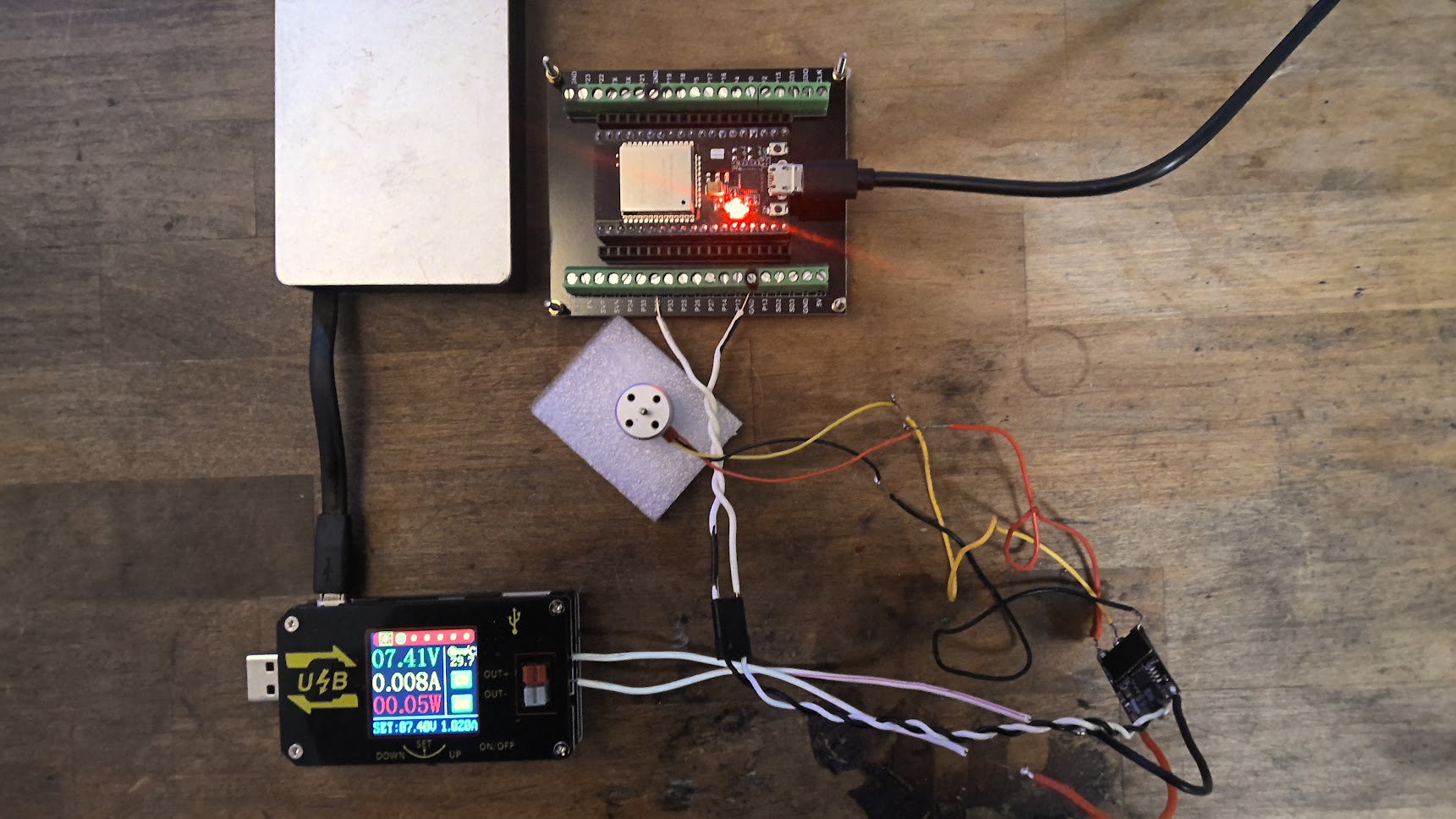

Hello, I'm new to esp32.
I'm trying to spin a small brushless motor using the dshot_esc example, provided with esp-idf.
I have everything wired up and I flashed the example code.
The esc gives a power on beep sequence but no arming beeps and no spinning.
I'm not sure what the issue is. Can anyone help troubleshoot?
Here is my test setup:
esp-32-wroom,
48MHz blheli_s esc (2-3s LiPo),
small bldc (1-2s),
power bank + boost converter to power the esc at 7.4v (2s LiPo)
BLHeli_S DShot esp-idf/examples/peripherals/rmt/dshot_esc

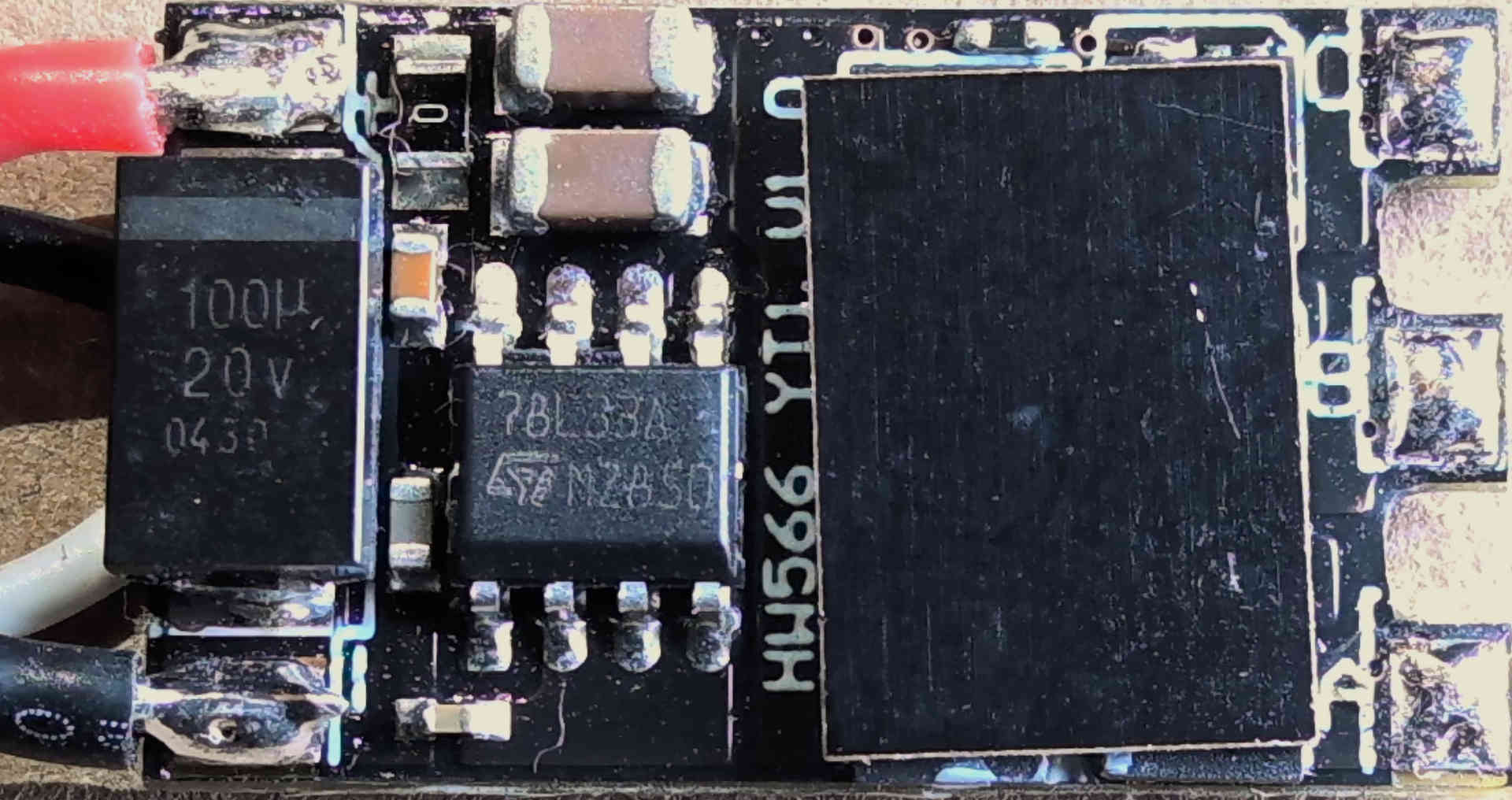

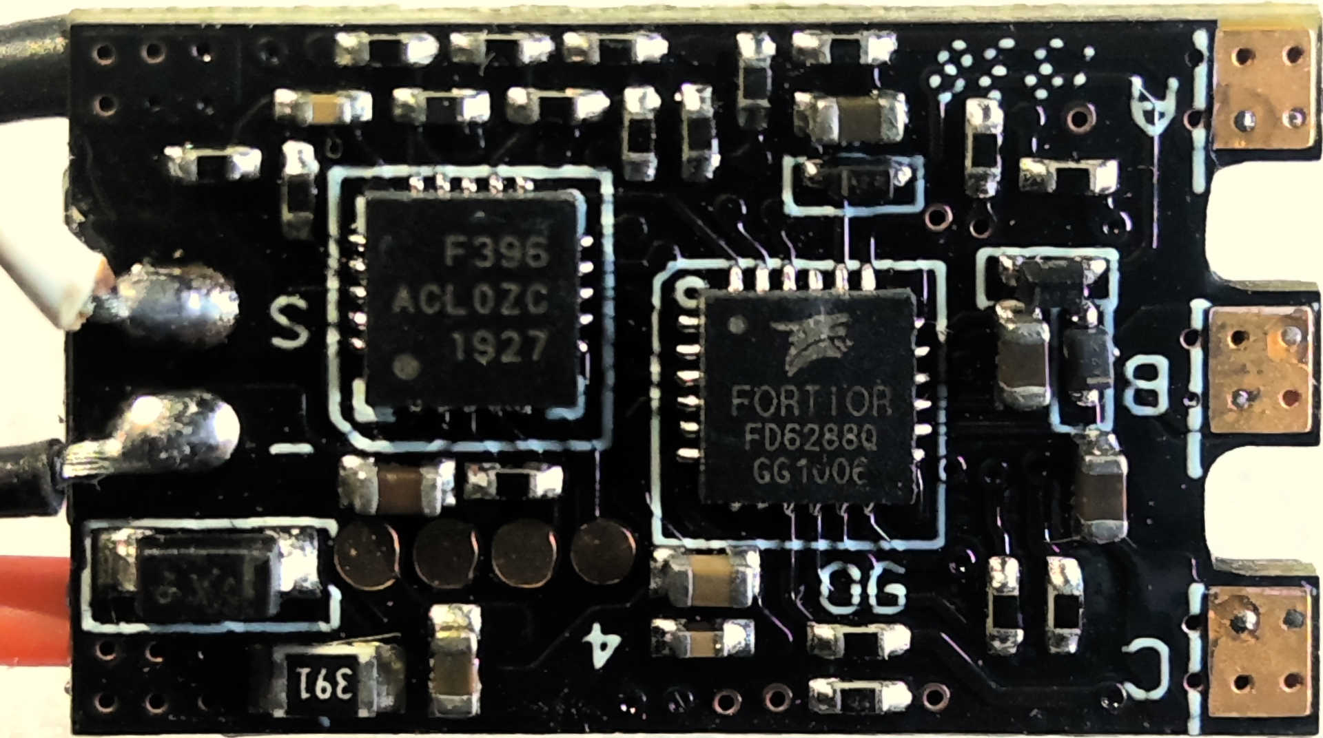

ESC Notes:
Info provided by the seller (Plus my notes):
2-3s 30amp BlHeli_S (Is it actually running BLHELI_S?)
Supported Modes:
Muted
OneShot42
OneShot125
MultiShot
DShot (Does it actually support DShot?)
Does a capacitor need to be removed to enable DShot?
MCU: Claimed to be SiLabs EFM8BB21F16 but it is actually SiLabs F396.
I took some photos of the board and found the relevant data sheets:
MCU: SiLabs F396, 50MHz (The actual mcu -- same processor core as EFM8.)
DataSheet: C8051F39x/37x
Driver: Fortior FD6288Q
DataSheet: FD6288T&Q
Linear Regulator: ST 78L33A
DataSheet: L78L
Can I use the esp32 to check which firmware the esc is running?
