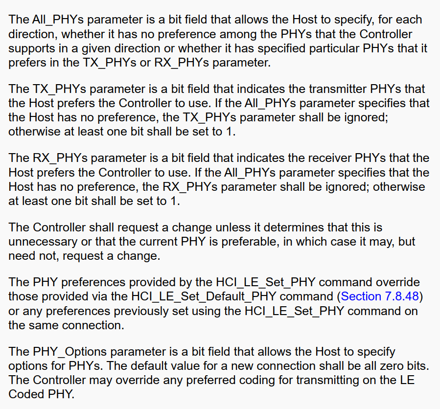

Re: BLE 4 Coded
How do you use the `esp_ble_gap_set_preferred_phy` API?
//when connected
esp_bd_addr_t remote_device_address = {0x12, 0x34, 0x56, 0x78, 0x9A, 0xBC};//peer bluetooth addr
esp_ble_gap_all_phys_t all_phys = 0;
esp_ble_gap_phy_mask_t tx_phy = ESP_BLE_GAP_PHY_2M_PREF_MASK; // 2Mbps data rate
esp_ble_gap_phy_mask_t rx_phy = ESP_BLE_GAP_PHY_2M_PREF_MASK;
esp_ble_gap_prefer_phy_options_t phy_options = ESP_BLE_GAP_PHY_OPTIONS_NO_PREF;
esp_err_t result = esp_ble_gap_set_preferred_phy(remote_device_address,
all_phys,tx_phy,rx_phyphy_options)
Each parameter's specific description can be found in the BLUETOOTH CORE SPECIFICATION Version 5.4 | Vol 4, Part E page 2440.

MicroController
- Posts: 2694
- Location: Europe, Germany
Re: BLE 4 Coded
Then you probably want to use ESP_zhanghaipeng's code withI want to use BLE 5 coded at the longest range possible
esp_ble_gap_phy_mask_t tx_phy = ESP_BLE_GAP_PHY_CODED_PREF_MASK;
esp_ble_gap_phy_mask_t rx_phy = ESP_BLE_GAP_PHY_CODED_PREF_MASK;
esp_ble_gap_prefer_phy_options_t phy_options = ESP_BLE_GAP_PHY_OPTIONS_PREF_S8_CODING;
esp_ble_gap_set_preferred_default_phy(ESP_BLE_GAP_PHY_CODED_PREF_MASK, ESP_BLE_GAP_PHY_CODED_PREF_MASK);
