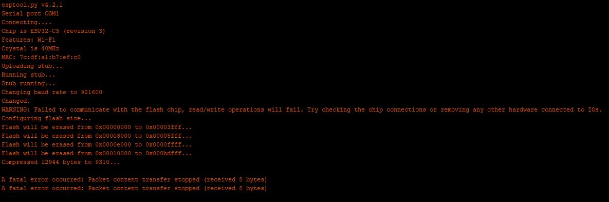

I have customized the ESP32-C3 Lolin mini and I have the following the error of attached picture, when I try to flash.
In boot mode I have GPIO2, GPIO8 high and GPI09 low, as indicated in the ESP32-C3 datasheet.
As you can see, the USB port can communicate with Esptool, but when it has to flash the data, it causes the error.
I have disconnected everything from the GPIO and the error continues.
On the original Lolin ESP32-C3 mini board the program loads perfectly, but on my custom PCB it causes the error.
Can you help me?
Thanks you.

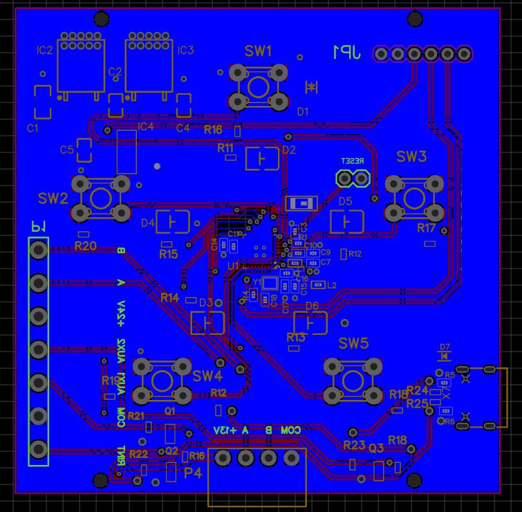

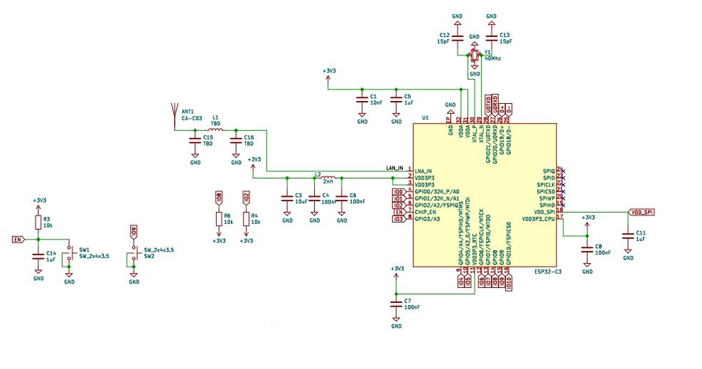

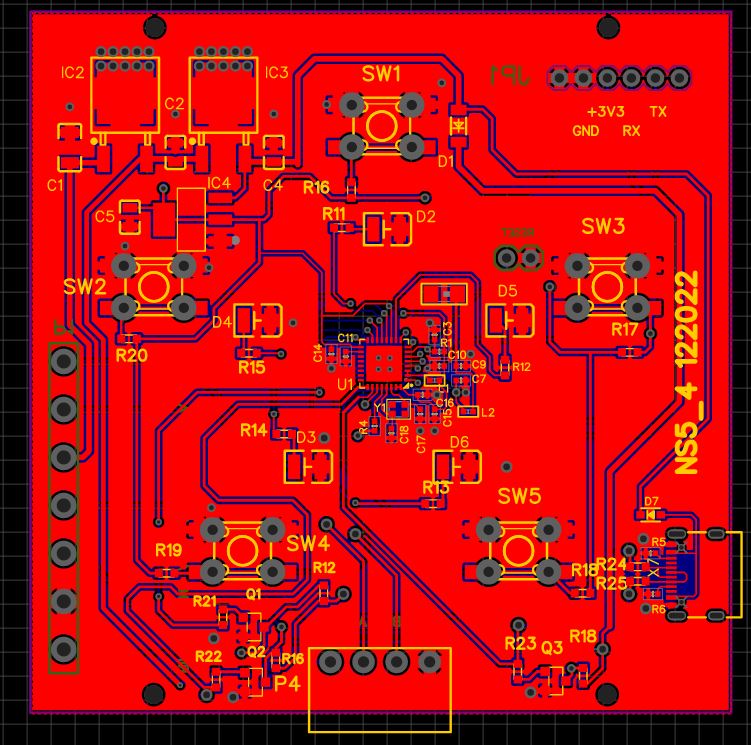

Attached TOP, BOTTOM and schematic.
I don't know why have I this error.
Yes, I have tried all baudrate speeds, low and high.
I have tried with external power supply 3.3V and the there is the same problem.
- PCB TOP
- Captura_top.JPG (136.98 KiB) Viewed 2515 times
- PCB BOTTOM
- Captura_bottom.JPG (106.96 KiB) Viewed 2515 times
- SCHEMATIC
- Captura_schematic.JPG (77.84 KiB) Viewed 2515 times

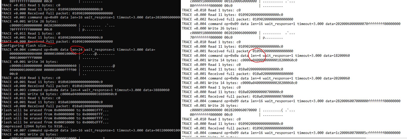

Attached with --trace option:

TRACE +0.336 Read 1 bytes: c0
TRACE +0.001 Read 13 bytes: 01070400df7c000000000000c0
TRACE +0.003 Received full packet: 01070400df7c000000000000
TRACE +0.007 command op=0x05 data len=16 wait_response=1 timeout=3.000 data=040000000100000000180000a86bc93f
TRACE +0.001 Write 26 bytes:
c000051000000000 0004000000010000 | ................
0000180000a86bc9 3fc0 | ......k.?.
TRACE +0.020 Read 1 bytes: c0
TRACE +0.001 Read 13 bytes: 01050400df7c000000000000c0
TRACE +0.003 Received full packet: 01050400df7c000000000000
TRACE +0.007 command op=0x07 data len=20 wait_response=1 timeout=3.000 data=
0400000000000000 0000000000000000 | ................
0c40c83f | .@.?
TRACE +0.004 Write 30 bytes:
c000071400540000 0004000000000000 | .....T..........
0000000000000000 000c40c83fc0 | ..........@.?.
TRACE +0.016 Read 1 bytes: c0
TRACE +0.002 Received full packet: 01070400df7c000000000000
Running stub...
TRACE +0.005 command op=0x06 data len=8 wait_response=1 timeout=0.050 data=0000000070063840
TRACE +0.000 Write 18 bytes:
c000060800000000 0000000000700638 | .............p.8
40c0 | @.
TRACE +0.009 Read 1 bytes: c0
TRACE +0.000 Read 13 bytes: 01060400df7c000000000000c0
TRACE +0.001 Received full packet: 01060400df7c000000000000
TRACE +0.014 Read 1 bytes: c0
TRACE +0.001 Read 5 bytes: 4f484149c0
TRACE +0.002 Received full packet: 4f484149
Stub running...
Changing baud rate to 921600
TRACE +0.000 command op=0x0f data len=8 wait_response=1 timeout=3.000 data=00100e0000c20100
c0000f0800000000 0000100e0000c201 | ................
00c0 | ..
TRACE +0.008 Read 1 bytes: c0
TRACE +0.001 Read 11 bytes: 010f0200000000000000c0
TRACE +0.001 Received full packet: 010f0200000000000000
Changed.
TRACE +0.056 command op=0x0a data len=4 wait_response=1 timeout=3.000 data=18200060
TRACE +0.000 Write 14 bytes: c0000a04000000000018200060c0
TRACE +0.005 Read 1 bytes: c0
TRACE +0.001 Read 11 bytes: 010a0200000000800000c0
TRACE +0.001 Received full packet: 010a0200000000800000
TRACE +0.004 command op=0x0a data len=4 wait_response=1 timeout=3.000 data=20200060
TRACE +0.001 Write 14 bytes: c0000a04000000000020200060c0
TRACE +0.001 Read 11 bytes: 010a0200000000700000c0
TRACE +0.001 Received full packet: 010a0200000000700000
TRACE +0.004 command op=0x09 data len=16 wait_response=1 timeout=3.000 data=2820006017000000ffffffff00000000
c000091000000000 0028200060170000 | .........( .`...
00ffffffff000000 00c0 | ..........
TRACE +0.000 Read 11 bytes: 01090200000000000000c0
TRACE +0.001 Received full packet: 01090200000000000000
TRACE +0.004 command op=0x09 data len=16 wait_response=1 timeout=3.000 data=1820006000000090ffffffff00000000
c000091000000000 0018200060000000 | .......... .`...
90ffffffff000000 00c0 | ..........
TRACE +0.010 Read 1 bytes: c0
TRACE +0.001 Read 11 bytes: 01090200000000000000c0
TRACE +0.004 command op=0x09 data len=16 wait_response=1 timeout=3.000 data=202000609f000070ffffffff00000000
TRACE +0.000 Write 26 bytes:
c000091000000000 00202000609f0000 | ......... .`...
70ffffffff000000 00c0 | p.........
TRACE +0.002 Received full packet: 01090200000000000000
TRACE +0.004 command op=0x09 data len=16 wait_response=1 timeout=3.000 data=5820006000000000ffffffff00000000
c000091000000000 0058200060000000 | .........X .`...
TRACE +0.006 command op=0x09 data len=16 wait_response=1 timeout=3.000 data=0020006000000400ffffffff00000000
c000091000000000 0000200060000004 | .......... .`...
TRACE +0.005 command op=0x0a data len=4 wait_response=1 timeout=3.000 data=00200060
TRACE +0.001 Write 14 bytes: c0000a04000000000000200060c0
TRACE +0.007 Read 1 bytes: c0
TRACE +0.001 Read 11 bytes: 010a0200000000000000c0
TRACE +0.001 Received full packet: 010a0200000000000000
TRACE +0.004 command op=0x0a data len=4 wait_response=1 timeout=3.000 data=58200060
TRACE +0.001 Write 14 bytes: c0000a04000000000058200060c0
TRACE +0.000 Read 11 bytes: 010a0200ffffff000000c0
TRACE +0.001 Received full packet: 010a0200ffffff000000
TRACE +0.005 command op=0x09 data len=16 wait_response=1 timeout=3.000 data=1820006000000080ffffffff00000000
80ffffffff000000 00c0 | ..........
TRACE +0.004 command op=0x09 data len=16 wait_response=1 timeout=3.000 data=2020006000000070ffffffff00000000
c000091000000000 0020200060000000 | ......... .`...
WARNING: Failed to communicate with the flash chip, read/write operations will fail. Try checking the chip connections or removing any other hardware connected to IOs.
TRACE +0.005 command op=0x0a data len=4 wait_response=1 timeout=3.000 data=18200060
TRACE +0.001 Write 14 bytes: c0000a04000000000018200060c0
TRACE +0.002 Received full packet: 010a0200000000800000
TRACE +0.002 Write 14 bytes: c0000a04000000000020200060c0

Configuring flash size...

Flash will be erased from 0x00000000 to 0x00003fff...
Flash will be erased from 0x00010000 to 0x000bdfff...
Compressed 12944 bytes to 9310...

TRACE +3.001 Packet content transfer stopped (received 8 bytes)
A fatal error occurred: Packet content transfer stopped (received 8 bytes)
TRACE +0.004 command op=0x0b data len=24 wait_response=1 timeout=3.000 data=
0000000000004000 0000010000100000 | ......@.........
00010000ffff0000 | ........
TRACE +0.004 Write 34 bytes:
c0000b1800000000 0000000000000040 | ...............@
0000000100001000 0000010000ffff00 | ................
00c0 | ..
TRACE +0.006 Read 1 bytes: c0
TRACE +0.001 Read 11 bytes: 010b0200000000000000c0
TRACE +0.001 Received full packet: 010b0200000000000000
TRACE +0.005 command op=0x0a data len=4 wait_response=1 timeout=3.000 data=38880060
TRACE +0.000 Write 14 bytes: c0000a04000000000038880060c0
TRACE +0.000 Read 11 bytes: 010a0200000000000000c0
TRACE +0.008 command op=0x10 data len=16 wait_response=1 timeout=3.000 data=90320000010000000040000000000000
TRACE +0.002 Write 26 bytes:
c000101000000000 0090320000010000 | ..........2.....
0000400000000000 00c0 | ..@.......
TRACE +0.001 Read 8 bytes: 0110020000000000
Please, can anybody help me?

Attached the differences between original module and customized module (with error load).
The differences begin after "Configuring flash size...". Data len right is 24 and data len no right is 4.
I don't know why I can't uoload the firmware (Arduino ide) to customized module. I proved with some boards and the error is the same.
