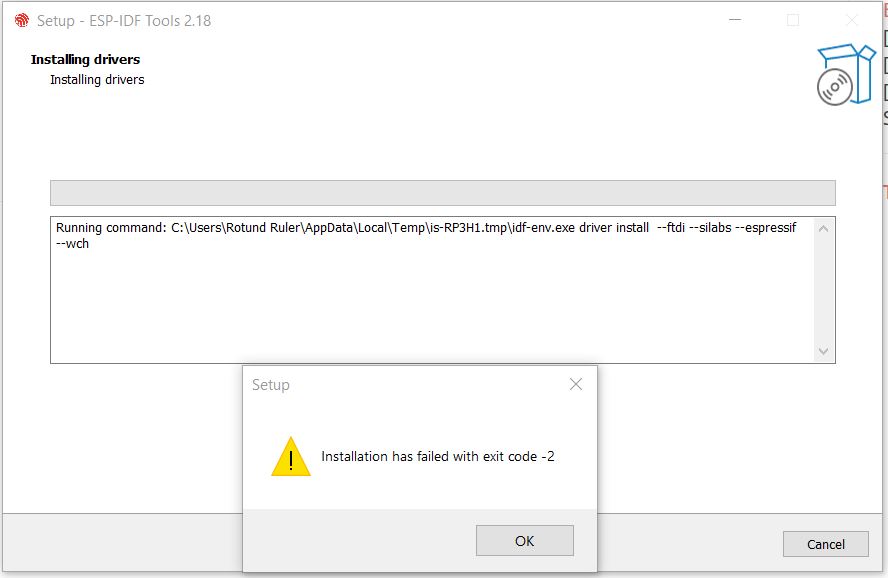

Having seen comparisons of ESP32 against Arduino I decided to go the ESP32 route. Great except I have spent 3 days try unsuccessfully to install and get working ESP-IDF. I have tried all the alleged fixes I have so far discovered but none of them seem to work. All I ever get is that damned "failed with error code -2" message. I'm beginning to wonder If I have made a mistake and would have been better off going with Arduino.

Are you simply venting or do you want help? Because if you want us to help you, you'll need to provide a bit more information: OS, versions, how are you trying to install ESP-IDF, are you using an IDE etc etc.

In response to ESP_Sprite, both of the above. My OS is windows 10, I have not installed an IDE (do I need to?"
, I go to this page https://dl.espressif.com/dl/esp-idf/ and attempt to install using this package "Universal Online Installer 2.18, Windows 10, 11, Size:4MB". I follow exactly the instructions presented and leave every setting at default and the response I get is "Installation has failed with exit code -2".

frankie53, if you have the log from the installer then please submit an issue here: https://github.com/espressif/idf-installer/issues
I have not tried the "universal" installer. I used the Offline installer for the specific ESP-IDF version I wanted (they offer 4.4.3 and 5.0).
