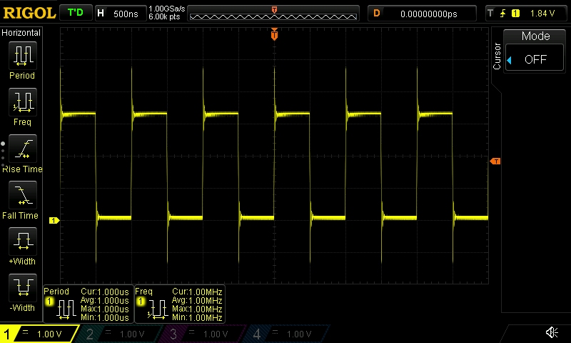

Viewing on an oscilloscope, Configuration 1 seems to work as expected.

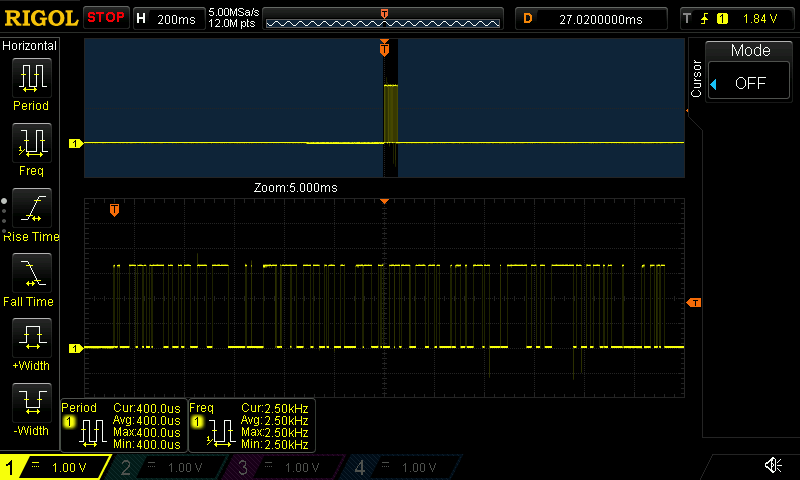

However Configuration 2 does not produce the expected signal (after some toggling it stays idle), and it also does not loop.
What might account for this behaviour?

Note: a divider of 40 with high/low counts of 40 does loop correctly, producing a 25kHz output.
EDIT: a divider of 13 with high/low counts of 40 does loop correctly. A divider of 12 does not.
div 13, high 1, low 1 produces 3.08 MHz.
div 12, high 1, low 1 does not loop.
