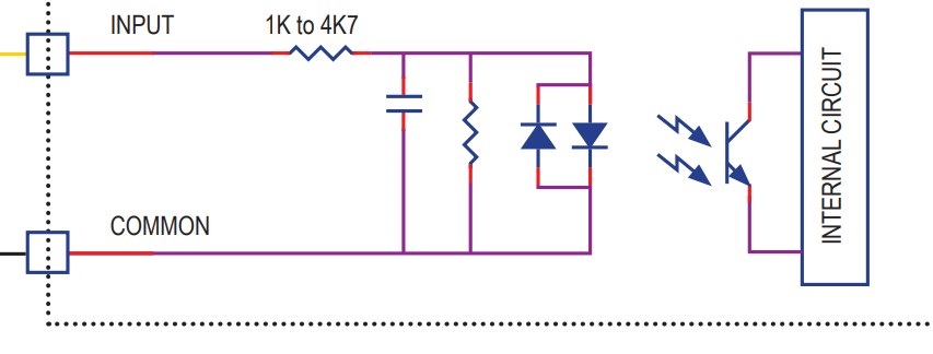

According to documentation it has already filter and third wire to give pulses:

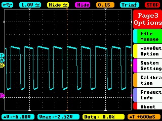

But problem still occure. I look on my small osciloscope to check how signals goes in 1 second and it look like this:
Rising edges are pretty sharp so I don't know why EPS printed me on console values 13-17 but when I see there are no 13 Rising edges in one second.
I added addictional filter according to documentantion...
Filter in input
it changes falling edges to more smoother ones, but it changes nothing. I tried to measue Pulse Hz with osciloscope and my hair dryer for repeatable result, but on osciloscope was 30 HZ on counter there was about 140-170. Even if osciloscope have constant value, values on ESP hesitated between 140-170.
I don't know how to fix that problem. I read about Schmitt triggers, that can solve problem of values of pulses but,
PCE-WS was pretty expensive( about 140euros) and I don't know how they can work on PLC but not on ESP? Did PLC have some other stuff that can works well?
Have anyone have any idea how to solve that problem? I don't rule out that my oscilloscope is bad, but most of time values can be high even if Fan is rotates very slow.

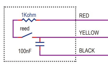

This is how I connected to LOLIN32 Lite. Test was also on esp32 doit devkit v1 with the same result. DC connector was for power supply and White wire was to Yellow on Anemometer. Capacitor are 100nF and resistor is 1k
