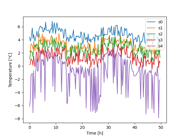

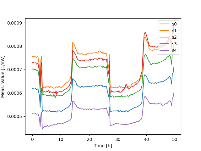

I have an application where we gather data from temperature and moisture sensors outdoors. Readings are taken every 15 minutes and between the readings the board goes into deep sleep. I use a SparkFun Thing Plus - ESP32-S2 WROOM board.
I am attaching some images of recent data. The sensors are buried in the ground with S0 being at a depth of around 1 m and S4 being barely covered with soil. S1 to S3 are on depths in between.
In order to take a measurement, the sensors are supplied with power through a transistor that is powered off afterwards.
I find it strange that i consistently get an offset of my moisture readings when the temperature crosses 0° C. Also, the temperature readings seem very noisy around 0°.
Is there some temperature dependency of the ADC? Am I missing something else?

Well, the fact that your voltage graphs look sane but the temperature one doesn't, assuming both come from the same ESP, implies that something is going wrong in your voltage->temperature conversion.
