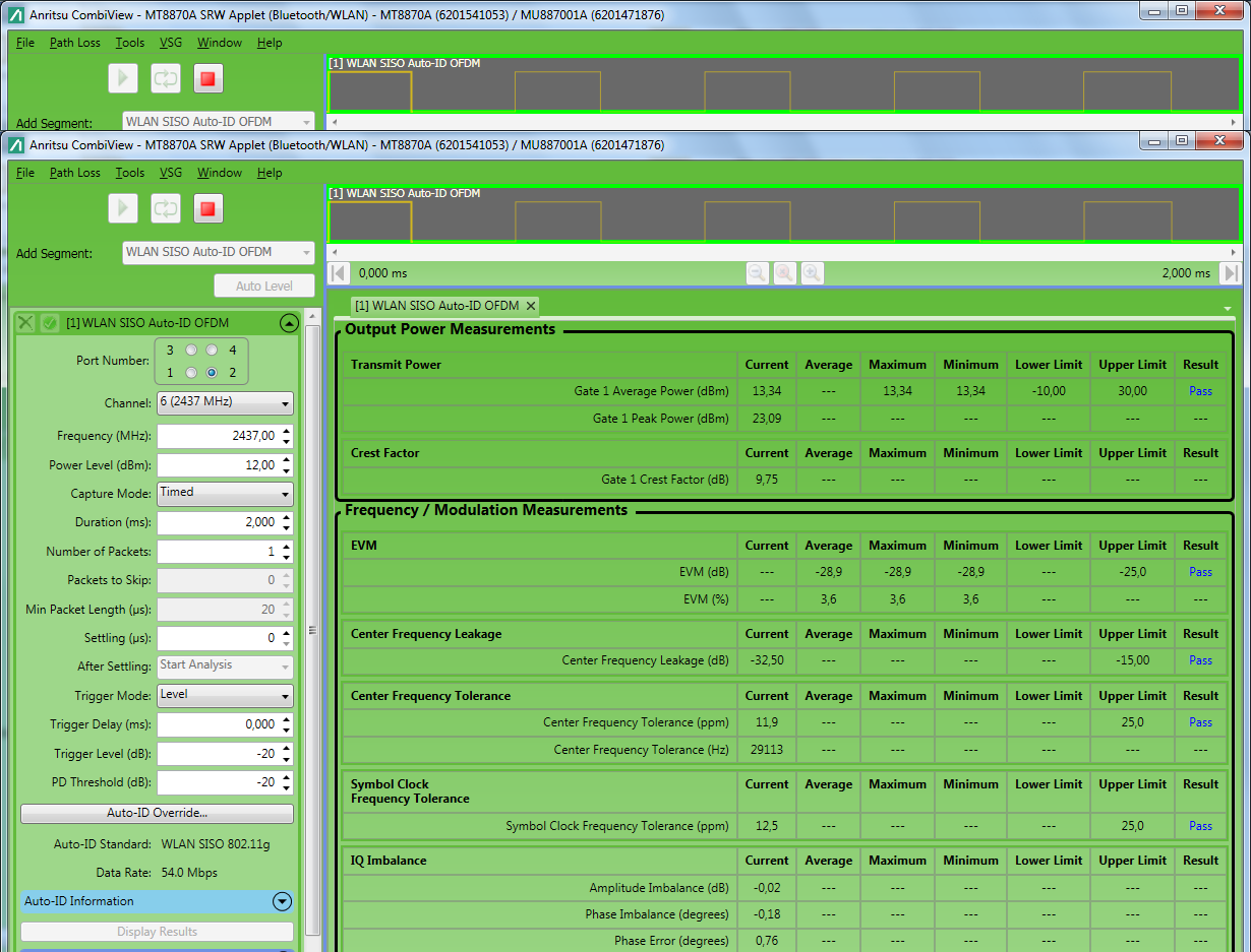

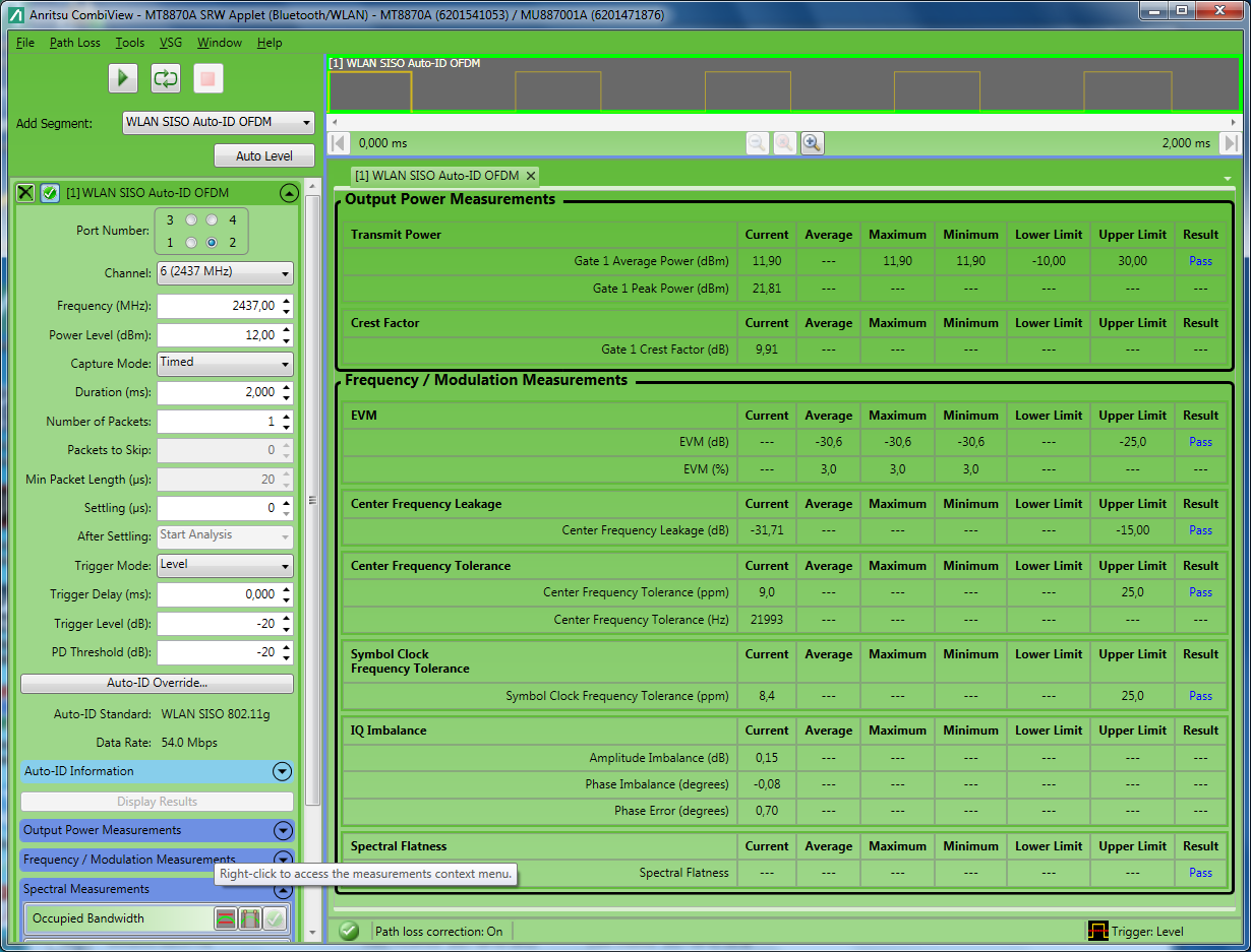

when testing RF tx characteristics at different temperatures we see that the output power and EVM values drift out of spec.
Ambient temperature changes and/or heavy RF activity will cause this. We test temperatures from -40C to +85C.
If the device is reset RF calibration is done and characteristics are ok again.
This behavior is seen in the attached screen dumps from measurements. At -40C the
the instrument can't even recognize the signal/data rate.
Normal room temperature, good signal:
Low temperature, bad signal:
Low temperature after reset, good signal:
-40C before reset
NINA-W131 #311 Wi-Fi Char 54Mbit -40C.png (219.81 KiB) Viewed 8315 times
-40C after reset
NINA-W131 #311 Wi-Fi Char 54Mbit -40C (after reset).png (219.63 KiB) Viewed 8315 times
25C
NINA-W131 #311 Wi-Fi Char 54Mbit 25C.png (208.41 KiB) Viewed 8315 times

Sorry that the problem does exist, because the RF test firmware has no periodic calibration function, it is a continuous package mode.
The SDK has periodic calibration functions that are not affected by temperature.
Currently the periodic calibration interface does not exist in the RF test firmware. But we will provide it in the future after verification.
