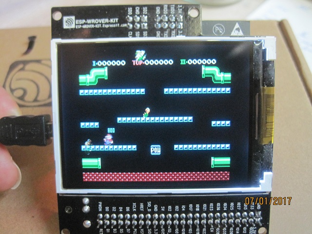

hi
cause tested with ESP32 WROVER KIT V2 ( black )
found out, that we must change a small thing.
https://github.com/espressif/esp32-nese ... _lcd.c#L53
/*orig WROVER KIT 1 ( red ) Backlight active high! */
// #define LCD_BKG_ON()    GPIO.out_w1ts = (1 << PIN_NUM_BCKL) // Backlight ON
// #define LCD_BKG_OFF()   GPIO.out_w1tc = (1 << PIN_NUM_BCKL) //Backlight OFF
/*rudi mod 06 jan 2017 on WROVER KIT V2 ( black ) Backlight active low! */
#define LCD_BKG_OFF()    GPIO.out_w1ts = (1 << PIN_NUM_BCKL) // Backlight OFF
#define LCD_BKG_ON()     GPIO.out_w1tc = (1 << PIN_NUM_BCKL) //Backlight ON
txs for your great work Jeroen!
now i need a PS1/PS2 Controller :mrgreen:
i usually do not play ;-) so sorry for this i have not PS1/PS2 controller here :oops:
see a sequenze on twitter

by a2retro
Hi Rudi, The ESP32-WROVER-KIT V2 will upload the latest code
Glenn@playpen MSYS ~/src/projects/esp32-nesemu
$ make flash
/home/Glenn/src/esp-idf/make/component_common.mk:1: Deprecated feature: No longer necessary to include component_common.mk from /home/Glenn/src/projects/esp32-nesemu/main/component.mk
Flashing binaries to serial port COM8 (app at offset 0x10000)...
esptool.py v2.0-dev
Connecting...
Uploading stub...
Running stub...
Stub running...
Changing baud rate to 921600
Changed.
Attaching SPI flash...
Configuring flash size...
Auto-detected Flash size: 4MB
Compressed 350976 bytes to 140590...
Wrote 350976 bytes (140590 compressed) at 0x00010000 in 3.0 seconds (effective 928.8 kbit/s)...
Hash of data verified.
Compressed 3072 bytes to 99...
Wrote 3072 bytes (99 compressed) at 0x00008000 in 0.0 seconds (effective 1641.4 kbit/s)...
Leaving...
Hard resetting...
and a ROM
$ esptool.py --chip esp32 --port "COM8" --baud $((230400*4)) write_flash -fs 4MB 0x00100000 MarioBros.nes
esptool.py v2.0-dev
Connecting...
Uploading stub...
Running stub...
Stub running...
Changed.
Wrote 32768 bytes at 0x00100000 in 0.5 seconds (547.6 kbit/s)...
Leaving...
Hard resetting...
but when it starts i get
Couldn't map rom part!
Initialized. ROM@0x20000000
Malloc: 4140 at C:/msys32/home/Glenn/src/projects/esp32-nesemu/components/nofrendo/nes/nes_rom.c:444
Head: 0x20000000 (0 c0 7e 66)
GUI:  is not a valid ROM image
GUI: ROM freed
GUI: ROM not loaded
NoFrendo died? WtF?
Did I miss a step?
Glenn
Re: NES emulator on an ESP32
Posted: Tue Jan 10, 2017 5:40 am
by a2retro
[23:00] <a2retro> Couldn't map rom part! err=> 258
[23:03] <Sprite_tm> That's ESP_ERR_INVALID_ARG
[00:17] <a2retro> Part => 300000
[00:17] <a2retro> Src_addr plus size greater then g_rom_flashchip.chip_size
[00:17] <a2retro> Couldn't map rom part! err=> 102
[00:18] <a2retro> 300000 is part.size
[00:19] <a2retro> ESP_ERR_INVALID_ARG returned from flash_mmap.c lines 91-92
[00:24] <a2retro> Part => 300000
[00:24] <a2retro> Src_addr 0x00100000 plus size 0x00300000 greater then g_rom_flashchip.chip_size 0x00200000
[00:24] <a2retro> Couldn't map rom part! err=> 102
[00:24] <a2retro> thats as far as i can take it for now
[00:27] <a2retro> perhaps my sdkconfig file is messed up?
[00:29] <a2retro> $ cat partitions.csv
[00:29] <a2retro> # Name,   Type, SubType, Offset,  Size
[00:29] <a2retro> # Note: if you change the phy_init or app partition offset, make sure to change the offset in Kconfig.projbuild
[00:29] <a2retro> nvs,      data, nvs,     0x9000,  0x6000
[00:29] <a2retro> phy_init, data, phy,     0xf000,  0x1000
[00:29] <a2retro> factory,  app,  factory, 0x10000, 0x0E0000
[00:29] <a2retro> nesgame,  0x40, 0x01,    0x100000, 0x300000
[00:36] <a2retro> sdkconfig has 4MB for flash size
Posted: Tue Jan 10, 2017 6:12 am
by Sprite
Maybe your flash size is set incorrectly? It's in make menuconfig, under 'serial flasher config'.
Posted: Tue Jan 10, 2017 2:14 pm
by a2retro
Hi it is set for 4MB. I also tried a make clean and then a rebuild but no joy so far.
Posted: Tue Jan 10, 2017 2:44 pm
by a2retro
So after some googling i found and old workaround from ESP_igrr that forces the flash to be setup for 4MB.
SPIParamCfg(0x1540ef, 4*1024*1024, 64*1024, 4096, 256, 0xffff);
The game finally starts now but the back-light will not come on. When I press the enable button the back-light comes on momentarily, I can see the game screen and then it resets the game.
