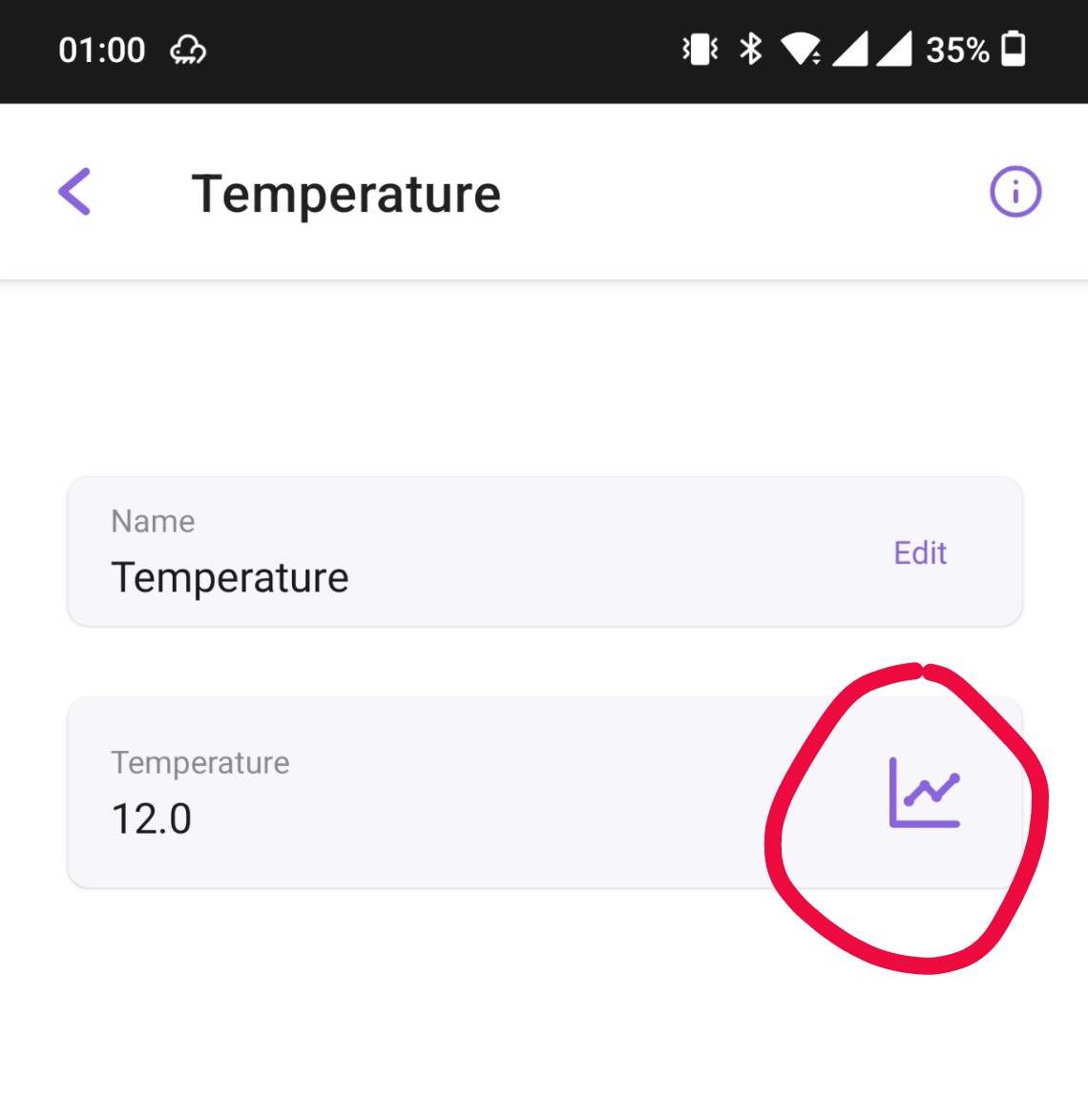

Hi, I can see the built-in available devices, e.g. Temperature has a 'chart' option that shows the sensor data history per day/week/month etc, which is super useful.
How can I have the same for a Custom device, e.g. if I am monitoring CO2 sensor reading? ...is there a way to add that feature?
Thanks!

While creating your custom parameter, you need to add the PROP_FLAG_TIME_SERIES flag. You can refer this page https://docs.espressif.com/projects/ard ... -param-api

Thank you!!
