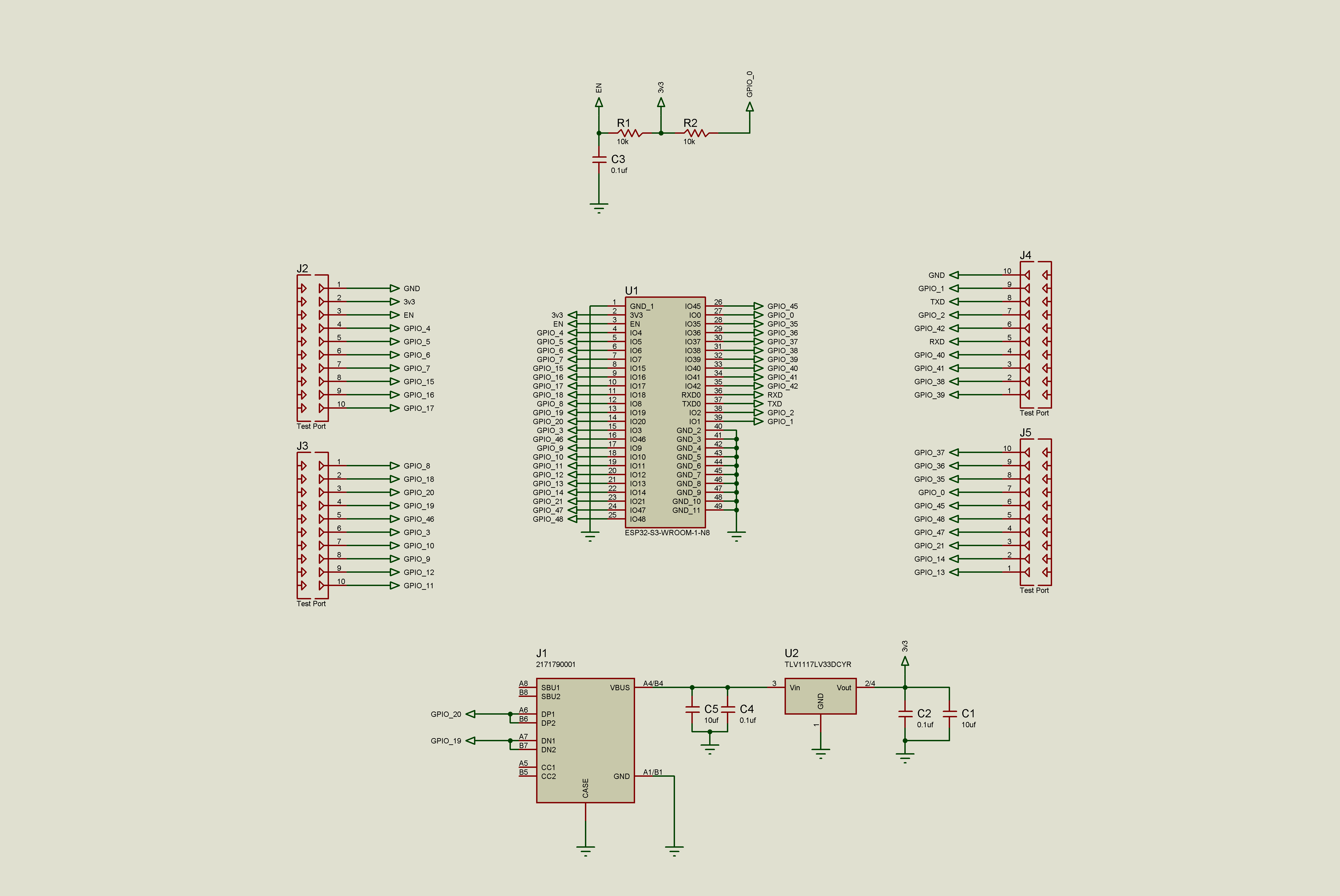

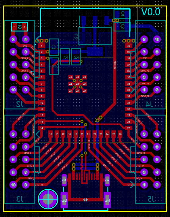

When I plug in an esp32-s3 with a usb cable
What exactly are you plugging in? You own board design or a dev kit, or other ?
Re: esp32-s3 serial port over usb
Posted: Sun Apr 16, 2023 10:40 pm
by atx823
My own board design. It's pretty simple - just an ap2115 regulator, a usb4105-gf-a receptacle, a couple of headers, and some buttons for EN and IO0.
Posted: Mon Apr 17, 2023 1:41 am
by username
Ah, ok. IF you willing to post the schematic we can take a look.
Posted: Mon Apr 17, 2023 1:52 am
by atx823
Cool, thanks.
s3 schem.png (23.66 KiB) Viewed 8887 times
s3 pcb.png (224.11 KiB) Viewed 8887 times

Nothing jumped out at me for the USB connections.
Though, If I might nit pick. You really need to add caps on that board.
There should be at least a 0.1uf cap on the input to the regulator, and output. Would be better to also include >4.7uf to them as well.
I did a board similar 2 weeks ago, and It worked just fine.
Posted: Mon Apr 17, 2023 2:21 am
by atx823
Good point on the caps -- I'll add them. Thanks for taking a look.
