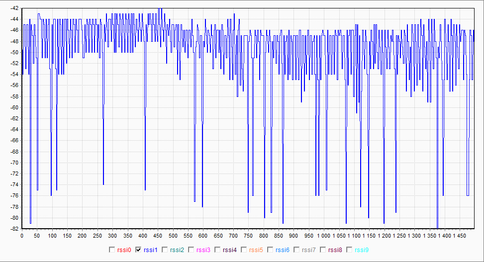

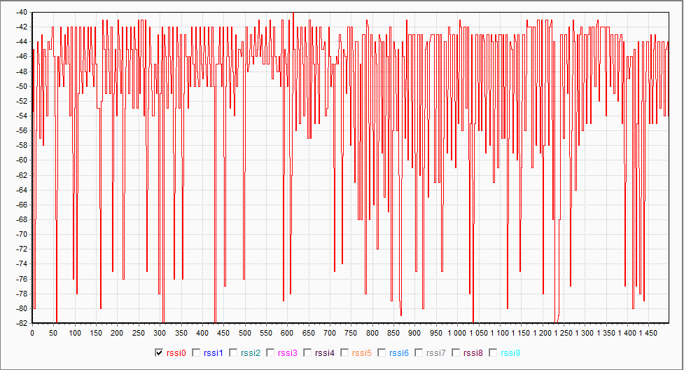

I have a ESP32-C3 module and it's programmed with an app that continuously scans for BLE advertising packets using NimBLE Host (ESP-IDF 5.0.1). Whenever advertising packet is received, an event of type BLE_GAP_EVENT_EXT_DISC (extended advertising is enabled) is raised and in the data of that event a RSSI can be retrieved:
event->ext_disc.rssi
The problem is that this value periodically drops to the level of around -80 dBm. Charts are present for two different advertiser devices.

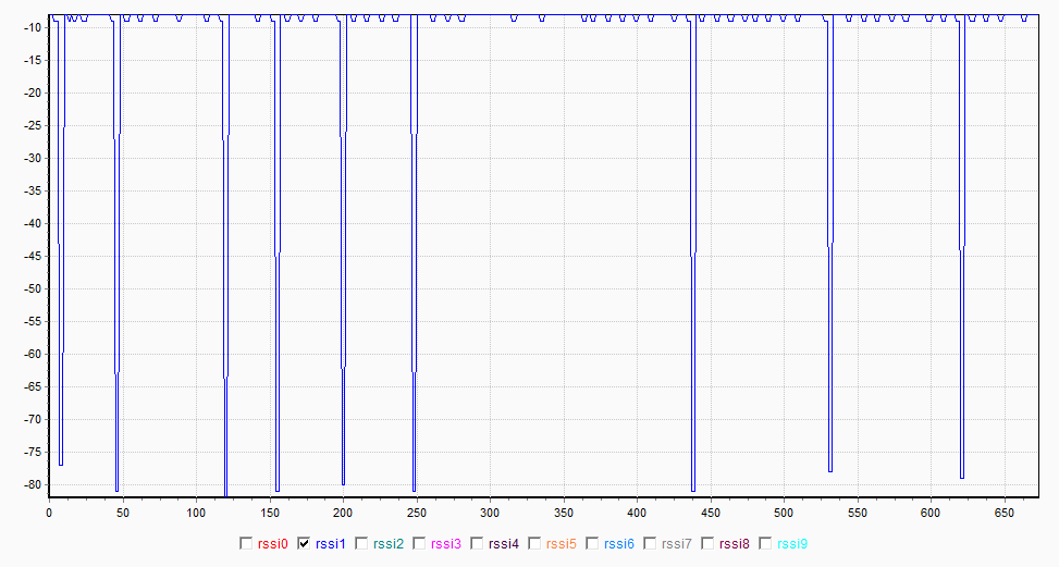

Maybe it's related to something like Wi-fi transmissions or other interferences, but this RSSI drop look suspicious and artificial. Even if I bring two devices very close to each other, so the scanner device would report maximum possible rssi (which is only -8 dBm for some reason), the drops are still there and again rssi value frops to the level of around -80 dBm! Here's the image:
If it were 'real' signal level drop, it wouldn't go down to -80 dB both from -45 dBm and -8 dBm.
I tried scanning with the different BLE modules from different manufacturers and didn't observe any drops. I also scanned with my Android phone and nRFConnect app and there were no drops either.
I tried changing scanning parameters (scan interval, scan window), changing various Bluetooth Controller options in menuconfig, but the result is still the same.
