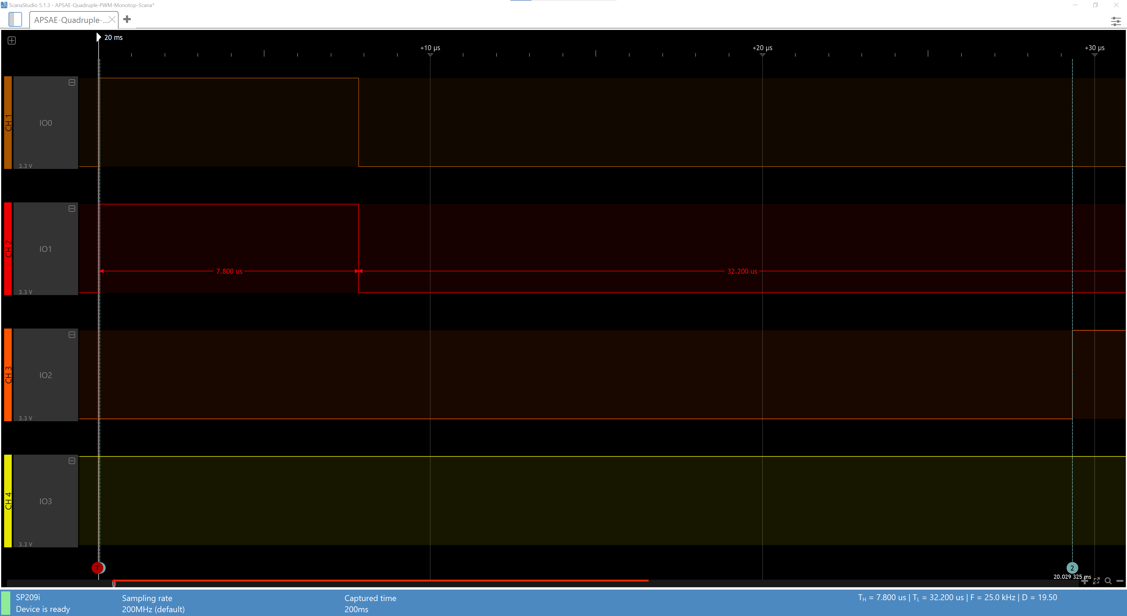

- I need to generate 4 PWM signals 25 kHz.
- They must start at the same time.
So I started by doing a search. I found indications with "ledc". Ok I started a code.
I can’t generate the 4 signals. One is frozen at 1 logic and doesn’t go down.
They are stripped using this method.
I’m looking for a way to keep the ledcSetup() and ledcAttachPin() configuration working. But I would have to write a solution to replace the 4 ledcWrite() that do not do the job properly.
At the limit, I have a test code to show you what I did, a copy of the statement I made with scanastudio. Maybe someone can help me recode a little in order to generate the 4 signals correctly.

   * @brief We are looking to generate 4 identical signals starting at the same time.
  ledcWrite(IO0_PWM_CH0, 50);
  ledcWrite(IO1_PWM_CH1, 50);
  ledcWrite(IO2_PWM_CH2, 50);
  ledcWrite(IO3_PWM_CH3, 50);
  delay(100); // For measurement
  ledcWrite(IO0_PWM_CH0, 0);
  ledcWrite(IO1_PWM_CH1, 0);
  ledcWrite(IO2_PWM_CH2, 0);
  ledcWrite(IO3_PWM_CH3, 0);
  /* At this place, I’d like to do this */
  // Same PWM started at the same time
  //write(IO0_PWM_CH0, 50, IO1_PWM_CH1, 50, IO2_PWM_CH2, 50, IO3_PWM_CH3, 50);
  // PWM started at the same time with a different frequency
  // write(IO0_PWM_CH0, 50, IO1_PWM_CH1, 100, IO2_PWM_CH2, 150, IO3_PWM_CH3, 200);
  while(1); // Stop generating signal

I’ve come a long way on the use of LEDC.
It turns out that timing by cannaux is risky. On some frequencies, they synchronize randomly.
I ended up doing something, but:
  • hpoint is innaccessible from the ledc library (see probably to overload the library), with a little help, why not.
  • Perhaps review the architecture of the code so that synchro/deasynchro can be done properly.
  • Rectify the use of timers to make it less problematic even when we are forced to use delay().
