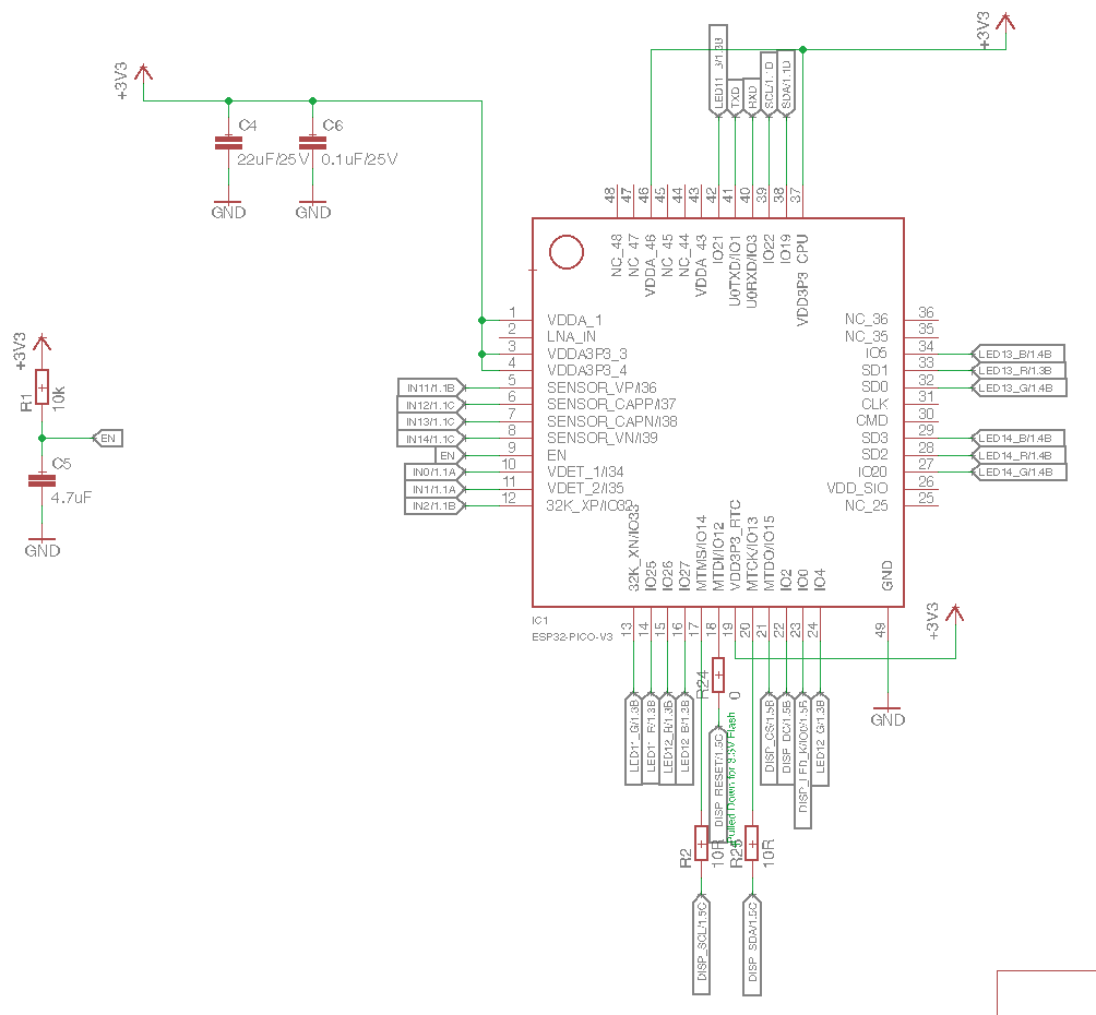

I am up to now using more than a few thousand WROOM32 and WROVER32 modules so far and now I am struggling with a simple problem, but I can not find the issue up to now in my hardware design.
The problem is simple:
-> Flashing the unchanged hello_world example to a custom ESP32 PICO V3 board works (see output later in this post)
-> Starting the module does not work (it hangs in a loop with RTCWDC_RTC_RESET) (see output later in this post)
What I have tried to far:
-> MTDI is floating to ensure 3.3V flash supply
-> burning the Fuse, that even if there is some bootstrapping problem to ensure 3.3V flash supply
-> trying a different 3.3V power
-> trying to disconnect every soldered peripheral like Display LEDs and switches
-> the same hello_world example flashed to one of our WROOM32 board or a DEV board comes up without any problems
Any ideas? I assume a simple stupid mistake, but I spent hours and meanwhile it is really nothing connected except the programming Pins and the EN lowpass.
It think about a powers supply issue, perhaps one bad soldered Pad or so, but what can cause this behaviour? (there are more than one Power Pins in that QFN, but if flashing works, so there it seems to be a connection to the embedded flash)
Thanks!

Postby Sprite » Fri Apr 28, 2023 5:27 am
If anything, you're missing pin 43 - that should also be connected to 3.3V.

Postby Volvox » Tue May 02, 2023 7:10 pm
Thanks for this quick reply. I knew that it must be a stupid issue, but that stupid... :D
I will fix this and check if it is working then.

Postby Volvox » Wed May 10, 2023 8:19 am
Yes, everything fixed, thanks a lot :)
