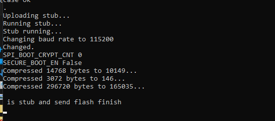

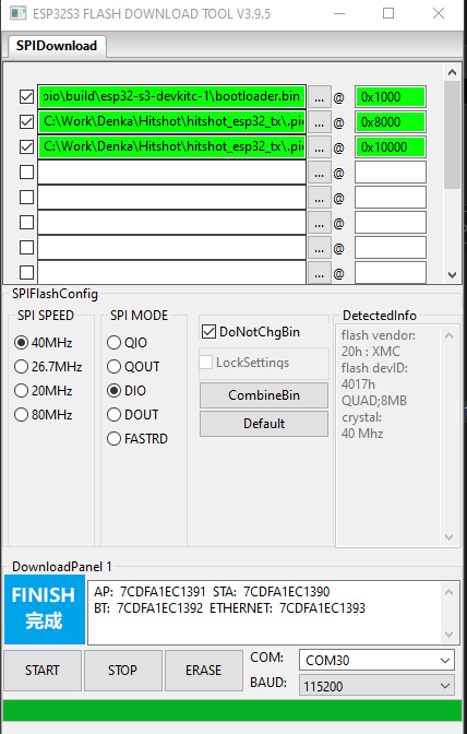

I'm trying to download the bin file to an ESP32-S3 on a custom PCB using Flash Download tool v3.9.5 and an ESP-prog, but it does not work.
I am able to upload and run my firmware using Platform,io.
Screenshot 2023-06-22 101858.png (36.27 KiB) Viewed 9097 times
Screenshot 2023-06-22 101945.png (14.53 KiB) Viewed 9097 times
Any suggestions on how to get this working?

Looks to me like it successfully flashed; how do you figure it didn't work?

I tested it with a board with the firmware already loaded through my IDE.
After I upload using flash tool the code doesn't start up.
Are my addresses maybe wrong?

Possibly. If any, I seem to recall that for an S3 the bootloader starts at address 0. Not sure if PIO works that way as well, but for ESP-IDF, after flashing, you can find a file called 'flash_args' in the build folder that tells you where the binaries should be flashed.

This worked, setting the bootloader to address 0x00.
