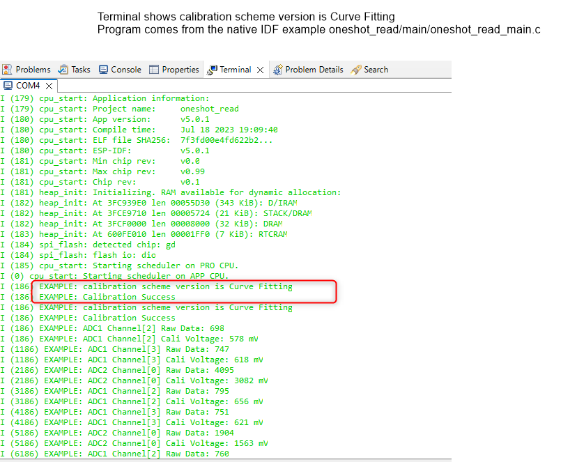

Now I run
esp_adc_cal_value_t efuse = esp_adc_cal_characterize(ADC_UNIT_1, ADC_ATTEN_DB_11, ADC_WIDTH_BIT_12, 0, &adc_chars);
with the 4th param set 0. Value of efuse returns 3, but adc_chars.vref remains 0.
Not sure if it is a problem of my chip so I turned to the native example esp-idf\examples\peripherals\adc\oneshot_read\main\oneshot_read_main.c but it confirms that my chip supports a calibration scheme of Curve Fitting (see attachment for results).
What did I miss with esp_adc_cal_characterize()?

ESP32-S3 uses ESP_ADC_CAL_VAL_EFUSE_TP_FIT curves. https://github.com/espressif/esp-idf/bl ... read.c#L46
The vref is going to be 0. I don't know the exact math of those curve fits, but it is coeff_a that actually varies per chip.
