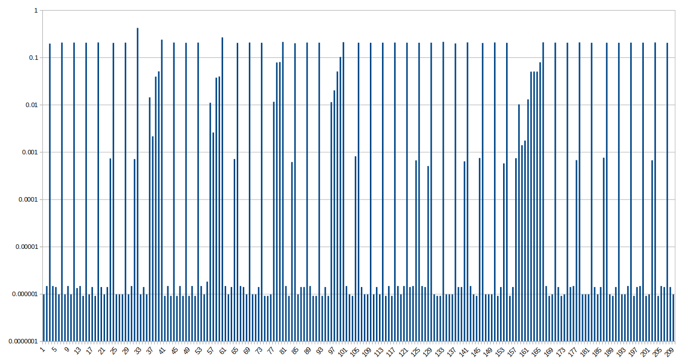

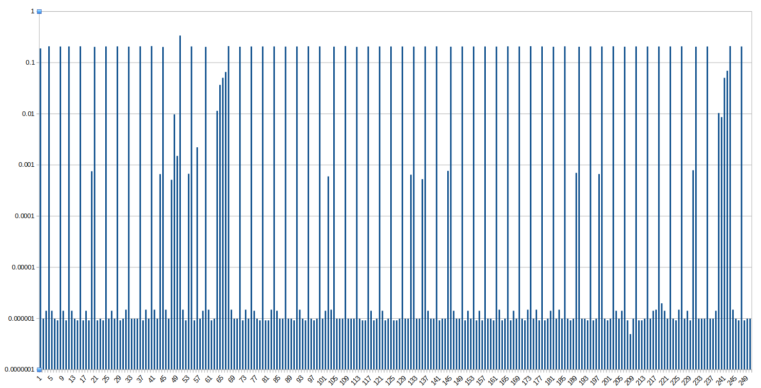

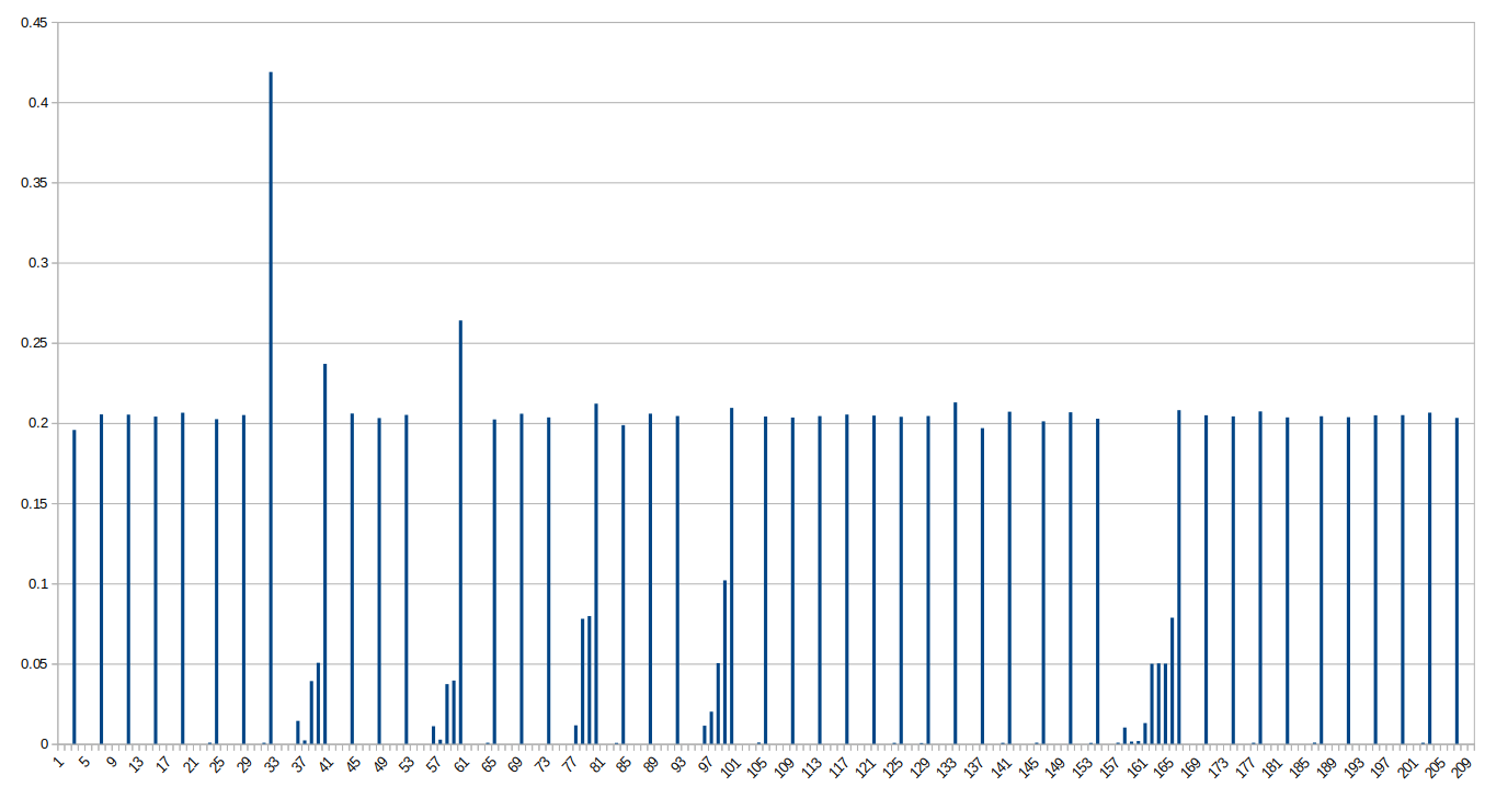

Greetings! I am using an ESP32-C3 with the attached short ESP32 Arduino program, which is a minimal repro of my application.
I expect that the program should send one packet every 50 ms. What I see, running Wireshark on a computer on the same Wi-Fi network, is that the traffic is "bursty".
Attached is a sample of the inter-packet delays, on a linear and a logarithmic scale.
* On the linear scale below, you can see that, on average, something happens every 200 ms to deliver a "burst" of packets.
* On the logarithmic scale below, you can see the actual distribution of the packets that arrive almost "simultaneously" with the previous ones.
Proper timing is important for my application. The receiving end is not an ESP32.
Is there an explanation for this? Is there something that can help?

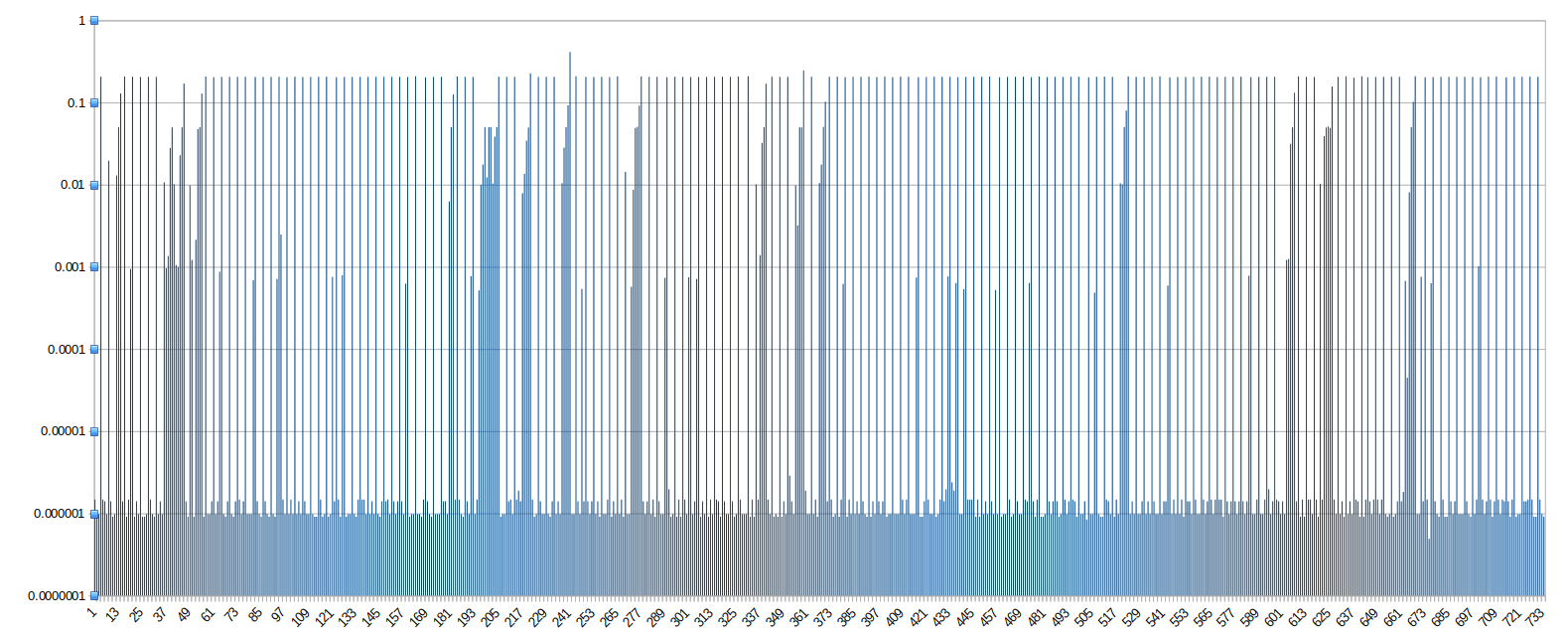

Greetings again folks,
I have rewritten my example using ESP-IDF -- without Arduino -- and had the same results. Below is the logarithmic plot of inter-packet times. I have also attached a ZIP file of my code. The main section of code is also below.
This is a critical issue for my application. I am surprised this is the behavior.

I tried some more experiments and found that the behavior is to some extent dependent on the receiving Wi-Fi adapter. I tried receiving the UDP packets on my laptop using the built-in adapter versus a USB Wi-Fi dongle, and in some cases (though the results were inconsistent), I received properly spaced UDP packets.
I then returned to basics. I added
esp_wifi_set_ps(WIFI_PS_NONE)
to my actual Arduino code, and tried it out along with my Raspberry Pi CM4 receiving unit, for my actual application. This seemed to provide adequate response times.
As a result, I'm going to consider this issue solved for now, and see if I can address it systematically later. If it recurs, I will re-post here with what I have learned.
