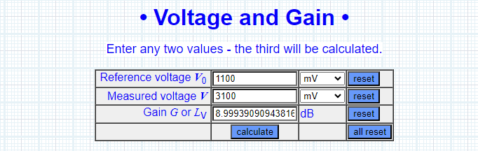

Hi
I am wondering how the results tabulated in the ADC Attenuation section is calculated.
If I use the equation as below, the max Vin with an attenuation of 11dB should be 3.9V something, but not 3.1V.
11dB = 20*log(Vin/Vref) dB
Vin = Vref * arclog(11/20) = 1100*3.548 = 3902.94mV
If we really want to get a max voltage input of 3100mV from 1100mV, the attenuation is 9dB. See results from an online calculator as follows:

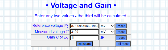

techtoys
Posts: 28
Joined: Sat Jun 01, 2019 11:11 am
Re: How the max Vin of 3100mV is calculated from an attenuation of 11dB?
Postby techtoys » Mon Aug 21, 2023 10:08 am
b) the true reference voltage can range from 1000 mV to 1200 mV among different chips."[/url]
c) The "attenuator" may have unspecified variations too
Voltage reference became 873mV if we apply a measured voltage of 3100mV with 11dB (see screen shot attached.)
This value deviates a lot from 1000mV to 1200mV.
However, when the arduino function analogRead() is used to return the raw ADC count, it returns 4095 when the applied voltage is 310xmV which is fairly accurate. What I am wondering is that, the attenuation stated at 11dB is not really 11dB.
